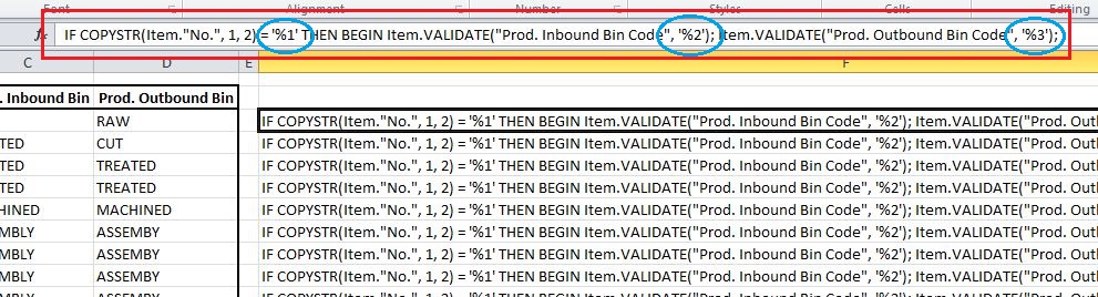

Add the code for the IF statement with the modifications to the records in a cell in the Excel spreadsheet and where the item number part and bin codes are put something that can be replaced by Excel. In the case below I used ‘%1’, ‘%2’ and ‘%3’ (why not use some NAV syntax :-)).
CAL-Code-In-Excel
Then in another cell in the Excel spreadsheet, create a formula and use the SUBSTITUTE function three times to replace the ‘%1’, ‘%2’ and ‘%3’ with the item number parts and bin codes. This then creates the proper C/AL code for the IF statement, just drag it down and you have all the IF statements you need.
Substitute-Parts-Of-Code-For-Bins

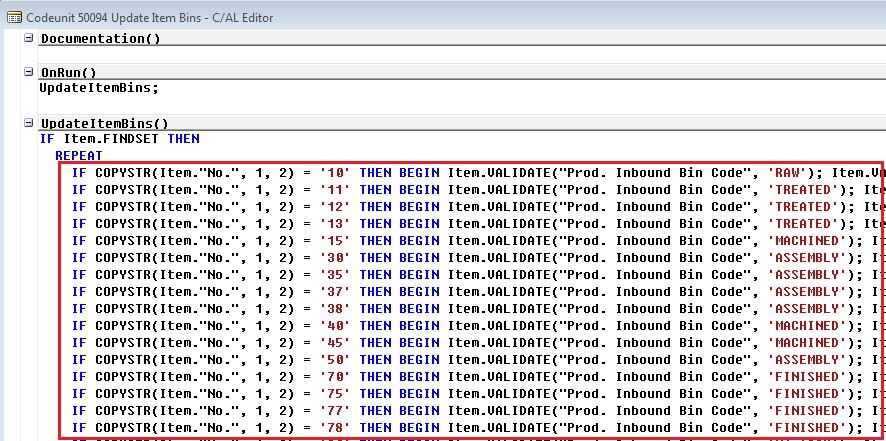

This can then be copy/pasted into Dynamics NAV and placed within a loop like below (or place it a report).
CAL-Code-Copied-From-Excel
Agree, it looks a bit weird to have the IF statement, the fields and the MODIFY statement all on the same row, but since this is a onetime update to the records it is less of a problem. Since we now, starting in version 2013, can have 240 characters on a single line of C/AL code this approach could be very useful.
Then it is just to run the function and all the records gets updated.
If, for some reasons, the bins are going to be changed again, I just change them in Excel and copy/paste the code into Dynamics NAV again and run the function.
