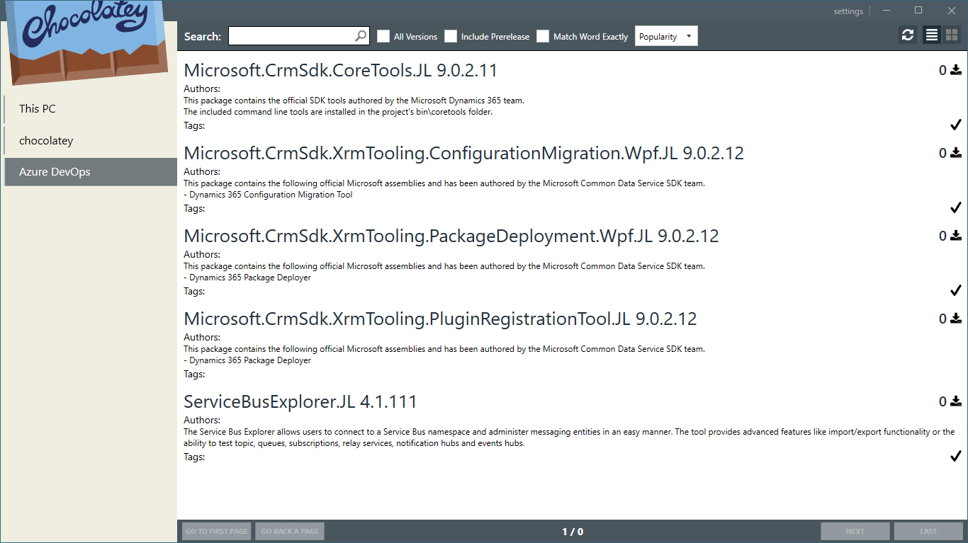

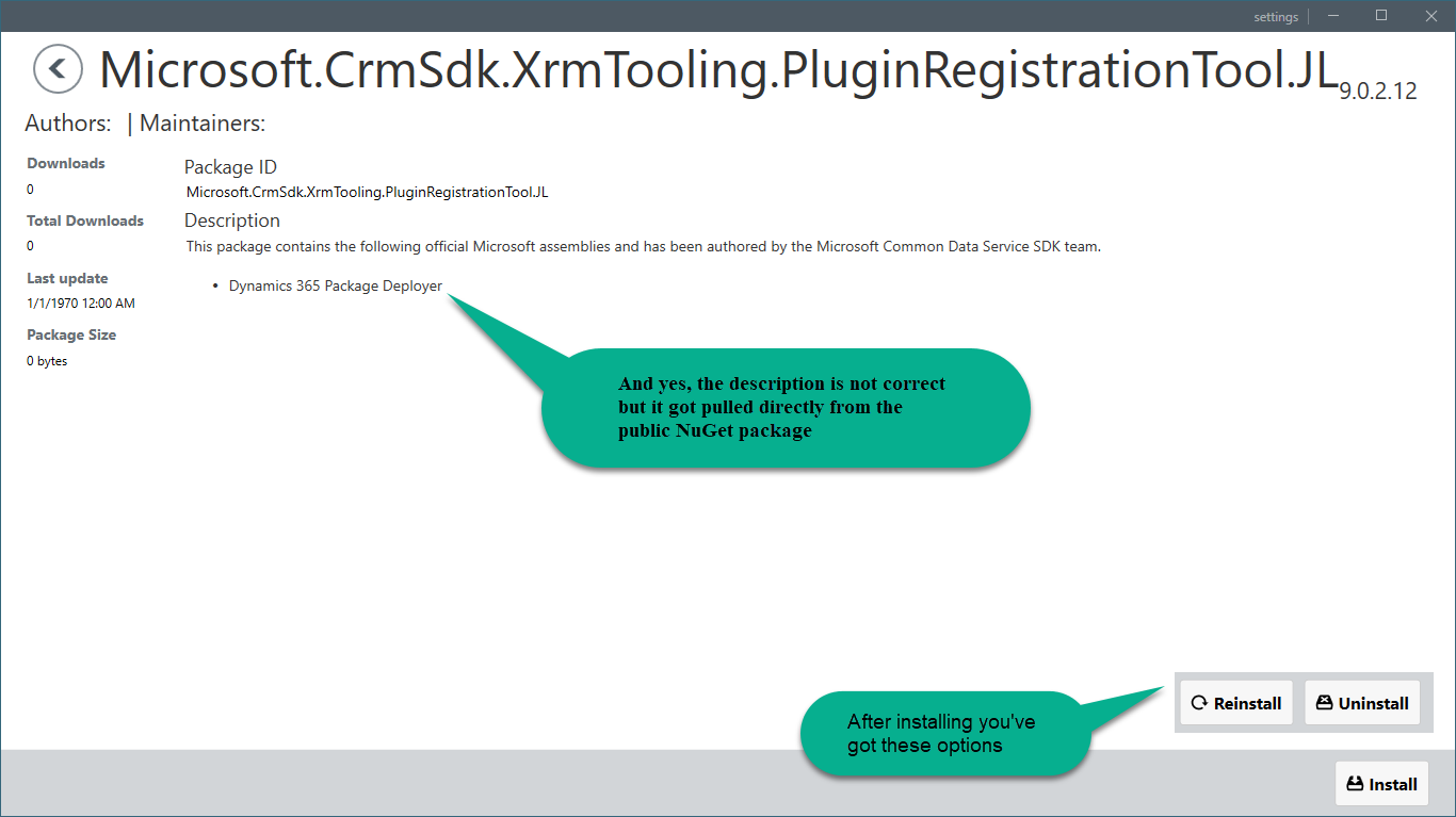

Here’s what you end up with after all this work. Click install and you’ll have the latest version of the tool installed in a few seconds. Click uninstall and with any luck (if you cleaned up after yourself properly) everything will be gone.
To connect to Azure DevOps go to Settings and then Sources.
The download counts, package size, or package image don’t get displayed. That seems to be an issue between Chocolatey GUI and Azure DevOps. Setting up a feed from a different private NuGet source didn’t do this.
