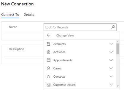

You’ll then be presented with the New Connection screen, where you’ll select the record that you want. Click the ‘All Records’ item at the top & then ‘Change View’ to select the actual entity that you’re wanting to look for:

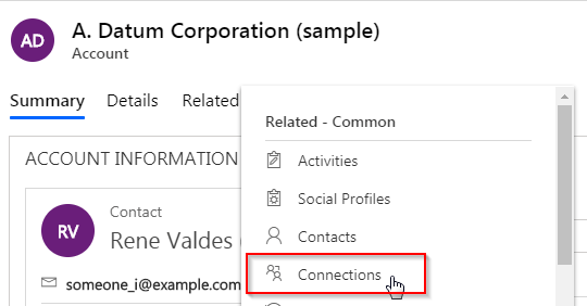

You then select the record that you’re wanting, and save. Hey presto, the two records are now connected! To see the connected records, look at the associated ‘Connections’ setting from either record:

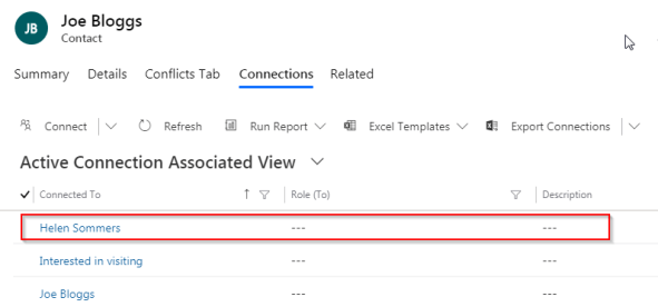

So you create the connection between the two records, and you set the attributes that you require. All good. What’s also good to remember is that Connections are bi-directional. You can view them from either ‘side’ of the connection. Eg:
Record 1
Record 2
That’s actually really helpful & useful in the normal scheme of things. You can easily see connections from either side.
But there’s a catch, or even (in our case above), an issue. If we open up each of the two Connection records, we’ll see the following data.
Joe Bloggs connecting to Helen Sommers:
Helen Sommers connecting to Joe Bloggs:
Can you spot the issue? Of course you can! On BOTH of the connection records, the custom fields that we set have the same values. We originally connected Joe Bloggs to Helen Sommers as the Legal Guardian, Power of Attorney & Trustee. Well, if we open up the connection record from Helen Sommers, we’re seeing the same values set, just in the opposite direction!
