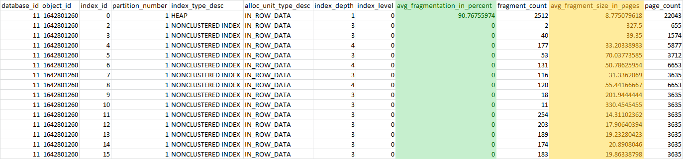

1. The first thing we will do is take a look at the stats on the GL00100 table by running the Microsoft SQL Server sys.dm_db_index_physical_stats function:
The following are the results from those stats:

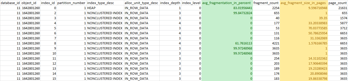

Now, in particular, I have highlighted the Average Fragmentation in Percent and the Average Fragment Size in Pages columns. Also, note that I have executed the function in 'LIMITED' mode, which combines information from all the columns that form part of each index. So, while these fragmentation levels would indicate low defragmentation rates -- which is always desirable -- it means there is still room for improvement. So, let's see what happens after rebuilding the indexes on GL00100 for our test database, then rerunning the stats:

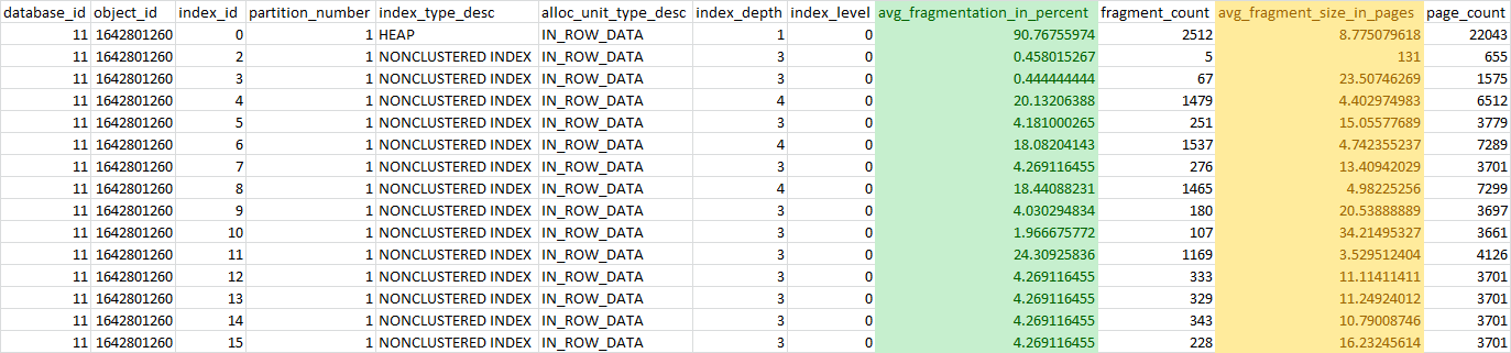

As you can tell now, we have no fragmentation and our page size utilization went up - this is what we would expect after rebuilding indexes. So let's see what happens when we run the shrink process on the database:
You can now tell that perfectly defragmented indexes now appear fragmented and even to a higher degree than what we started out with. These levels of fragmentation can cause serious performance issues in a production envrionment where database maintenance procedures are not properly planned and executed.
-- Created by Mariano Gomez, MVP
-- This code is licensed under the Creative Commons
-- Attribution-NonCommercial-ShareAlike 2.5 Generic license.
SELECT * FROM sys.dm_db_index_physical_stats
(DB_ID(N'TWO'), OBJECT_ID(N'dbo.GL00100'), NULL, NULL , 'LIMITED');
| Original database stats |
| Stats after rebuilding indexes |
| Stats after DBCC SHRINKDATABASE |
