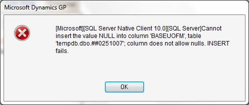

| Items list error |
Upon further review, the issue is due to bad data in the Unit of Measure Schedule (UOMSCHDL) column in the Item Master table (IV00101). In summary, if you have an item record with a blank Unit of Measure Schedule or a Unit of Measure Schedule that does not exist in the Unit of Schedule Master table (IV40201), it will cause the Items list to fail with the error above.
The following query should help in identifying the offending record(s):
' Created by Mariano Gomez, MVP ' This code is licensed under the Creative Commons ' Attribution-NonCommercial-ShareAlike 2.5 Generic license. SELECT * FROM IV00101 WHERE UOMSCHDL NOT IN SELECT UOMSCHDL FROM IV40201);
Once you have identified the record(s) causing the failure, you can use the Item Maintenance window to correct the problem:
