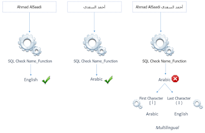

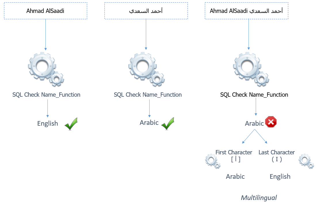

Now, the alternative of checking the pattern within the name which could be misinterpreted and processed, is to consider the first and last characters of the string, and compare the result with the original result retrieved by the function above. As follows:
SELECT  ( SELECT    dbo.Fn_CheckName(NAME)
        ) AS Language ,
        LEN(NAME) Length ,
        ( SELECT    dbo.Fn_CheckName(SUBSTRING(NAME, 1, 1))
        ) AS F_Character_Language,
              ( SELECT    dbo.Fn_CheckName(SUBSTRING(NAME, 2, 1))
        ) Second_Character_Checkname,
        ( SELECT    dbo.Fn_CheckName(SUBSTRING(NAME, LEN(name), 1)))
AS L_Character_Language ,
        name
FROM    [dbo].[namelist]
Here is the overall criteria when breaking down the name into characters and check the language of the first and last character to determine which is an Arabic, English or Multilingual field.
Process Visualization
