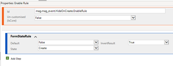

Here is the simple rule that I used to disable the button when the event is being created.
The Un-customised (IsCore) property is used to indicate if you are writing a custom command or using an existing command in CRM. Set to false if you are using a custom command for the button and set to true if you want to reference the enable rule within your solution without customising it.
The FormStateRule above is a step that has been added to validate that the form is not in a ‘Create’ state. The default field is used to specify whether the default value of the rule is true or false and the invertresult field is used to invert the result of the rule. In this case the FormStateRule is set at false to begin with and if the State is in a ‘Create’ state then the rule will be evaluated as true. We want to disable the button when the form is in a ‘Create’ state so we invert the result.

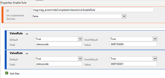

Below is the second rule I applied to the button, this one checks that the state of the record is not already ‘Completed’ or in the state ‘Cancelled’. We are evaluating a value within the form, in this case the statuscode, so we use a ValueRule. The default value of this rule is true and when the statuscode is equal to ‘Completed’ (809730000) or ‘Cancelled’ (809730001) this evaluates to true also. We want the button to be disabled when both these conditions are met so we invert the result.

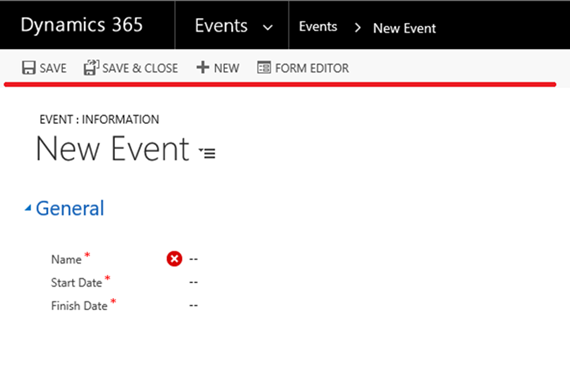

Below is the create page for a new event, if the button “Complete” was enabled here then the logic to change the event to complete would not make sense because the event has to exist before changing the status to complete.

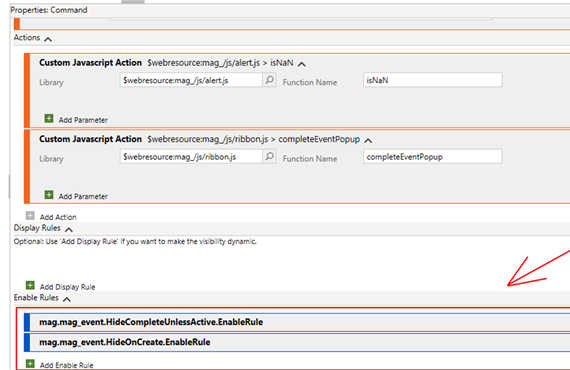

An important thing to remember is to add the enable rule(s) to the command. This is commonly missed, someone creates an enable rule but forgets to add it to the button command. This can be achieved easily as shown in the image below.

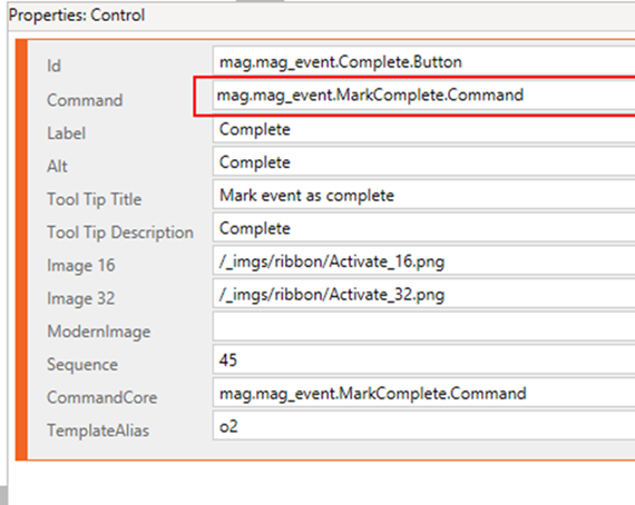

If you forget to add enable rules to the command then the button will show on all states/stages of the form. If you forget to add the command to the button, then the button will not show up on the form.
