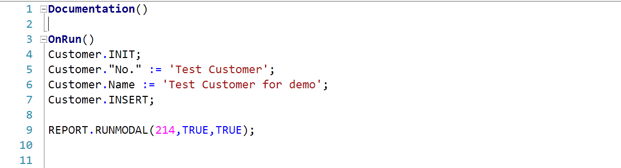

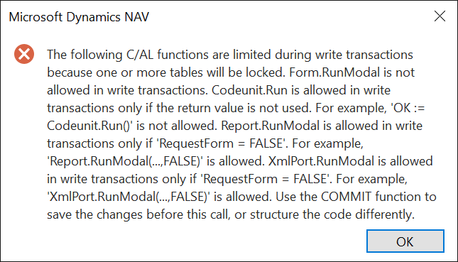

In order to check the simple scope I am planning to use below code. Pretty simple, its just inserting a record to Customer Table (T18) and trying to run a report using RUNMODAL

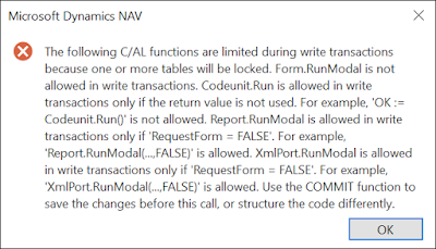

Even before we execute the code most of you knew what will happen if we try to run the above code. You will get most probably the largest or second largest error message in Dynamics NAV.

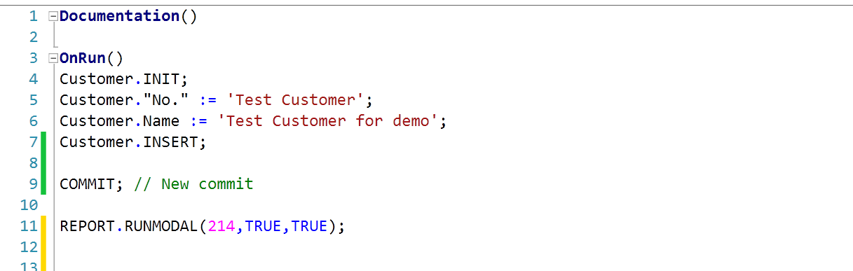

What will happen if we add a COMMIT
It runs without any issue and open up the Report Request page as define in the code. What this means is that once the COMMIT is called it will end a write transaction scope.

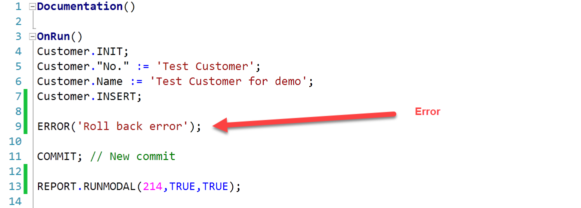

Lets do a small change,
When we run the code system throw out the Error message. Even though the error happen after the insert statement system rollback the transaction and move to the last system state. This is a one reason you never have to handle the transaction scope manually by you, NAV does it for you.  (Beautiful!)

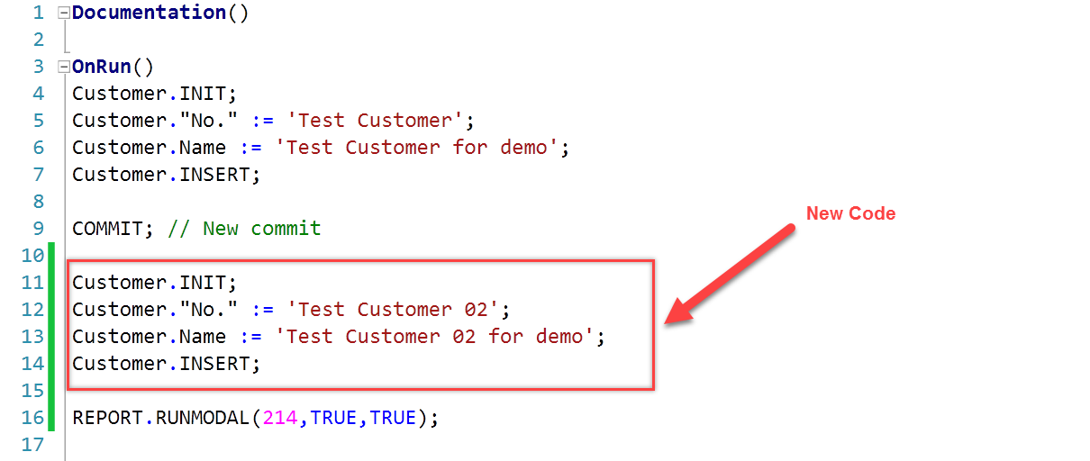

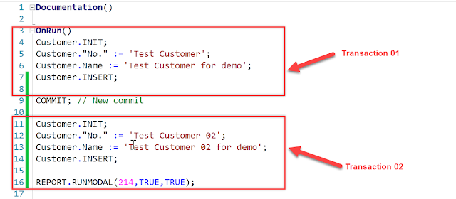

Lets do another change to our code, I removed the error code and added new code segment.

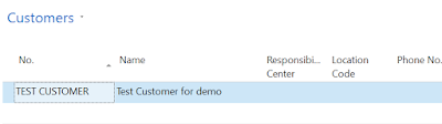

What will happen if we run this code? Wll get the same error what we received when we run the first segment of the code. However there is one small interesting thing in this code, to check that will open the RTC.
Dynamics NAV has inserted the first customer record to the table and never rolled back even though the error has occurred. Reason behind that is can be understand easily by referring to below image :
Once we do a COMMIT manually, Dynamics NAV register those transactions in Database and never go back and undo the changes even though error occurs afterward.
