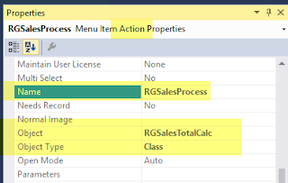

Now we create a new action type menu item for this class as shown below:

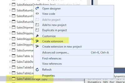

Create an extension of SalesTableListPage from : To do this, right click on the SalesTableListPage object in the AOT  and select "Create extension" . Make sure your model, where you are creating the project, has a reference to Application suite else this option will not be enabled.

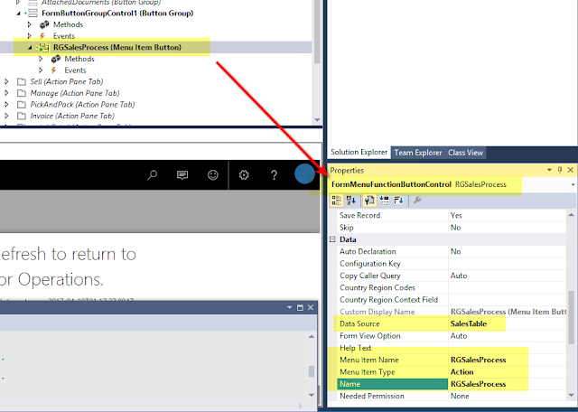

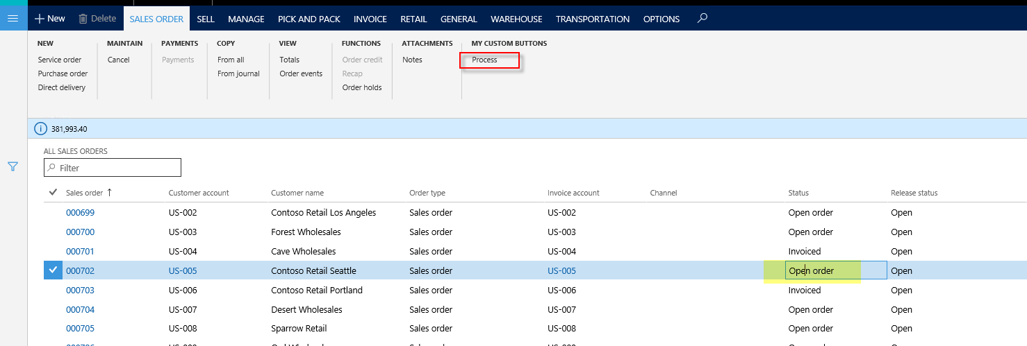

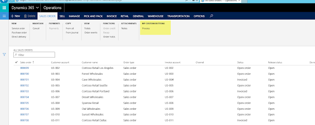

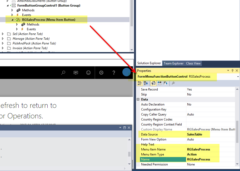

In the designer window, expand the design node and navigate to the action pane where you want to add the button. Let’s add a new button group and add the menu item we created
Verify that the menu item button is having correct properties and define the data source property as SalesTable
Build the project and test the button. When you open the sales table list page the new button is visible

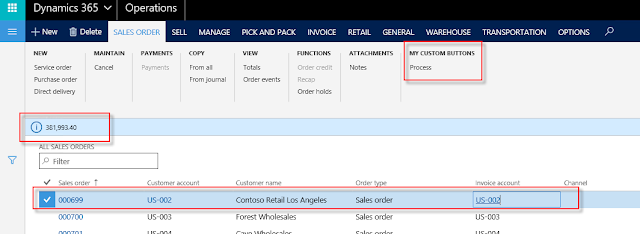

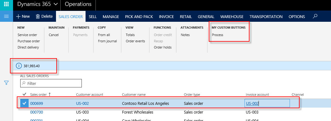

Click on the button just to make sure that it’s working. On clicking it we can see that Infolog is shown to display the Sales order total amount

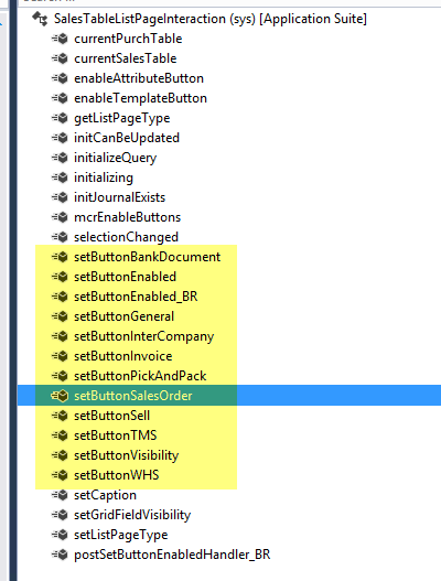

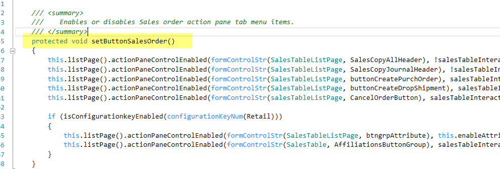

That means we need to subscribe to the method of the interaction class. We can see that interaction class as methods available which are pretty much self-explanatory by their names. We can see there are few methods which set the button properties

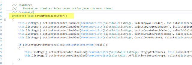

As we added the button in the sales order action pane group we can see that there is a method in this class which used to set buttons on the sales order action pane tab menu items . Notice that this is a protected method.

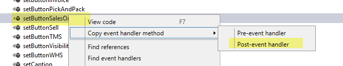

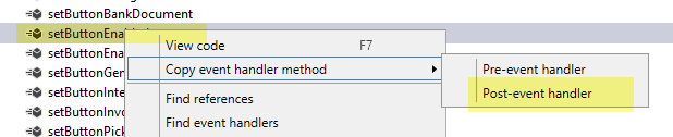

Ideally you may want to create an event handler for this method. Try to right click on this method and then select the option to create a post event handler
You will be greeted with the below error message. We can only create event handlers for Hookable methods. The definition of  Hookable method is also shown in the error message, these are non-abstract methods that are either public or tagged with the "Hookable" attribute as true.

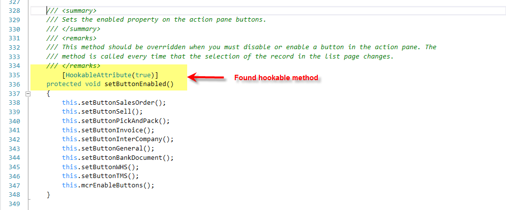

Let's find a hookable method in the interaction class:  On a quick scan in the class you can see that the setButtonEnabled() method is a protected method and decorated with the "HookableAttribute" as true.
This is an important point for ISV's to consider when design their solutions, as this attribute will be helpful to tag extension plugs.Let's create an event handler listener for this method

Now we build the project and run the list page form to see if the button is disabled for invoiced sales orders:
The button is disabled for an invoiced sales order
The button is enabled for a sales order having a status other than Invoiced.
