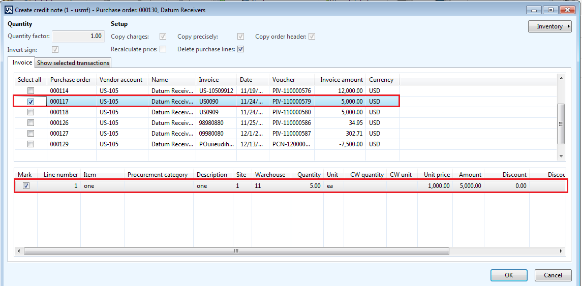

Add lines through Credit note
6. Go to Purchase order form-->click on purchase order lines--> Click on credit note
    or
    Go to purchase order form-->go to purchase fast tab--> click on credit note.
7. Select the appropriate purchase orders and their lines.
Note:We can select multiple purchase orders and their specific lines to get them in return purchase order. Purchase orders specific to vendor selected in the return purchase order can only be seen in credit note form.
8. Click ok to get the lines in return purchase order.

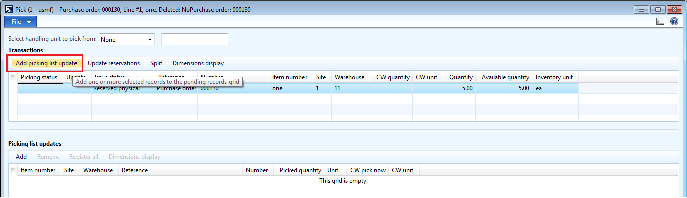

13.Unfortunately, it is impossible to create a picking task for a purchase order line (or for an output order that can be created for the purchase order line). So, we cannot use the Picking form (Inventory management > Common Forms > Picking routes). We assume that the Purchase Manager calls the Warehouse Worker and asks him to perform the picking task: pick the broken items from a specific location, transfer the broken items to the outbound location, and inform the Purchase Manager about the operation being completed. The Warehouse Worker receives this in an informal form from the Purchase Manager, because we can't create the picking instruction document in Microsoft Dynamics AX for the returned items. When the Warehouse Worker completes the picking task and informs the Purchase Manager, she or he does the following: in the lines area of the Purchase order form, click the Update line --> Pick button.
14. Click on Add picking list update button to get the items available for picking list update.
15. Click on Register all to update the picked item in the system.

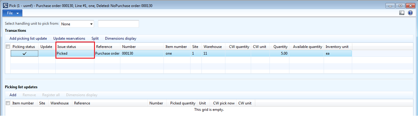

.16.Once done,Issue status goes to "Picked".
17. We can see inventory transactions status is updated from "Reserved physical" to "Picked".

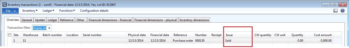

27. Go to inventory--> Transactions-->The status is updated from "Deducted" to "Sold".
