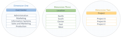

Multiple dimensions will be filled during the entry according to a predefined order, let's include the same previous example from the previous post, three dimensions which are: Cost Center, Location and Project.
Dimensions

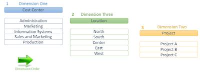

Suppose that there is a specific logic at filling the dimensions, which implies filling specific dimension before the other as shown below:
Dimension Order
In order to configure the required dimension order,Go to (Cards > Financial > Analytical Accounting > Transaction Dimension Order)
Transaction Dimension Order Setup
The window above controls how dimensions are entered, and the sequence of how codes are filled out at the entry level. Any of the dimension can be controlled to be moved up or down with the arrows on the right edge of the window.
