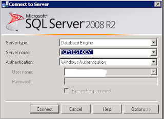

  1. Test  the connectivity on SQL Server is via Kerberos and not NTLM
Logon to SSMS (staying in the same box) and fire the below SQL, if SPN’s are properly setup, then you should see KERBEROS in auth_scheme field.

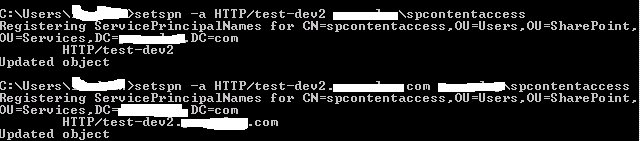

Register SPN’s for MOSS Server (Service account) in the similar fashion as we did for SQL:
  1. Register with NETBIOS name
  2. Register with FQDN name as shown below
