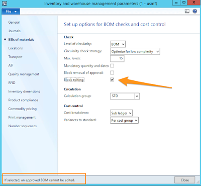

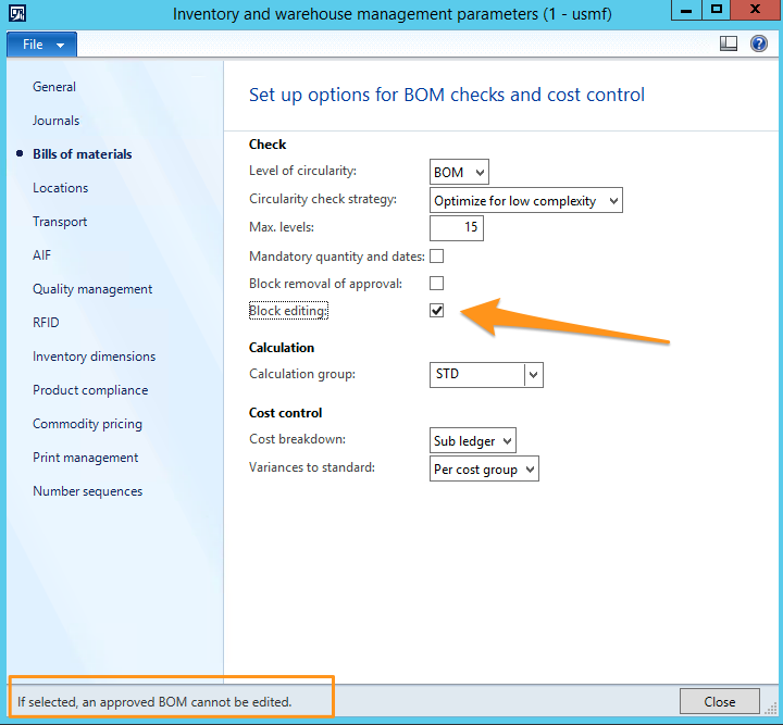

Block Editing of BOMs
There is an awesome parameter in Inventory management > Setup > Inventory and warehouse management parameters > Bills of materials called Block editing.
| If "Block editing" is selected, then an approved BOM cannot be edited. |
It states "If selected, an approved BOM cannot be edited." So, what does that mean?
Basically, there is an approval on a BOM and an activation on a BOM. By selecting this Block editing parameter, a BOM cannot be changed or adulterated in any way unless the approval on the BOM is removed.

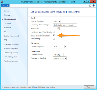

In Inventory management > Setup > Inventory and warehouse parameters > Bills of materials, there is another checkbox called Block removal of approval.
| Block removal of approval, when selected, will not allow anyone to remove an approval from a BOM. |
It states "If selected, an approval cannot be removed from a BOM or BOM version." The only scenario I can imagine this working well for is if a company uses a BOM for a certain period of time and puts an expiration date on it, then transitions to the next approved BOM after the expiration date has passed.
Using this method would keep a solid history of BOMs that were used during certain time periods and you would know that the BOM had not been adulterated at any time during that period because of this parameter.
