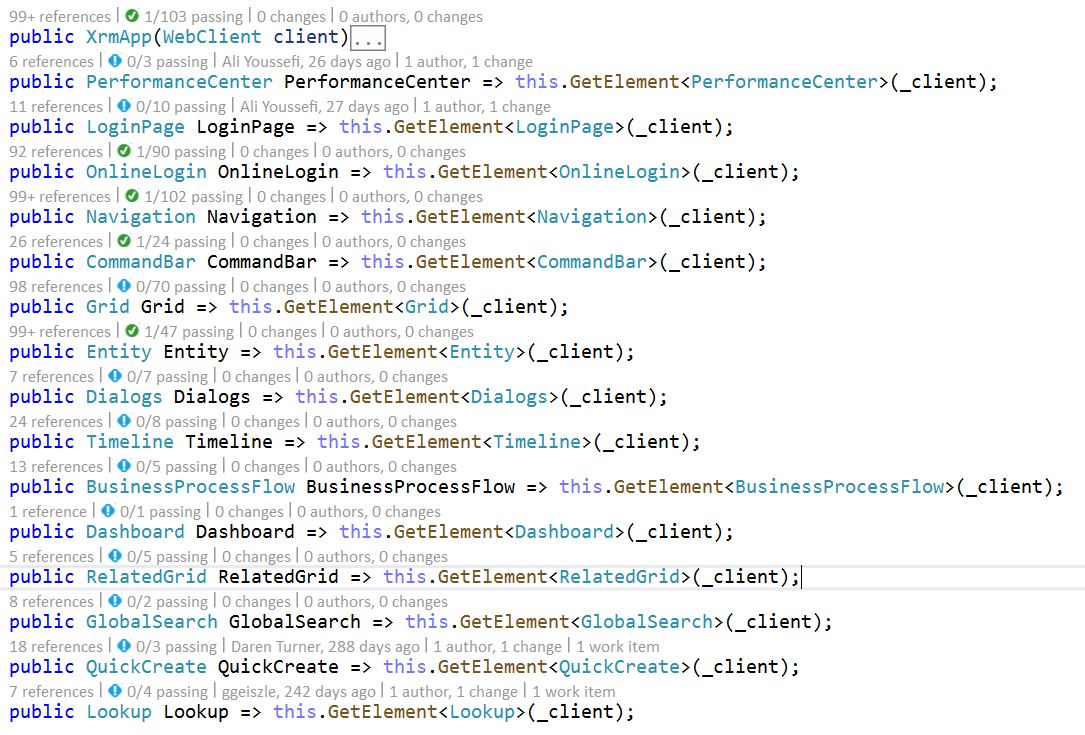

WebClient and XrmApp objects
The WebClient is derived from the BrowserPage class and injected into the XrmApp object. The WebClient contains mainly internal methods used by the XrmApp and platform element references such as OnlineLogin, Navigation, Grid, etc as shown in the unit tests above. Typically you will not be interacting with this object until you need to extend the framework.
The XrmApp is the primary way of navigating and commanding the platform. When opened you'll see the WebClient passed into each object used in the unit tests. Review this object to better understand each of the area of the platform you can work with in your unit tests.
As you can see, each of the commands in the Open Account unit test are represented by elements related to Dynamics. These elements include commands related to the object such as working with entity forms and navigating around the platform. Each element can be explored to determine what functionality can be achieved from the framework natively.

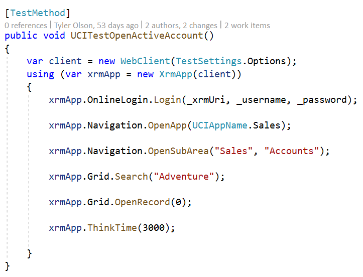

Commands
Let's review each one of the commands in the Open Account unit test to better understand what they are doing and where we may need to modify to better meet our requirements.
Login

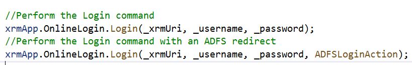

The Login method typically involves two paths: One using the standard Microsoft Office login and one that redirects to your organization's sign in page.
The first line shows passing in the URI of the organization, the username and password. How to set these values is covered in the first post in this series Test Automation and EasyRepro: 01 - Overview and Getting Started.
The second shows how to incorporate your organization's sign in page. Each sign in page is unique and will require understanding how to work with Selenium and the DOM of the page to input and submit these credentials. This will be covered in the Designing Tests towards Customization section.
Once the Login method has completed we will redirected to our default application in the organization. The next command details moving to another UCI application.
Open UCI App
The OpenApp method uses the UCIAppName class to navigate to a specific UCI app. The standard platform applications such as Sales Hub and Customer Service Hub, as well as others, are available in the class. I'll cover how to extend to a custom UCI app in the Designing Tests towards Customization section.
Open Sub Area
OpenSubArea introduces the first navigation into the sitemap of the Unified Interface. This method expects two parameters, the first identifying which area to open and the second which subarea to click. These string values are case sensitive.
Search
The Search method is used on the Grid object to search using the Quick Find view. Wildcard characters can be added here to simulate a user looking for values like or starting with specific characters if desired. For our unit test as long as we have the sample data in the organization we should pull up the Adventure Works (sample) record in the result set.
Open Record
The final navigation command in the unit test is to open the first record in the Grid using OpenRecord. As long as we pulled up the Adventure Works (sample) in our results this will open the first record based on the index of the rows in the view. If the index is outside of the bounds an exception will be thrown.
Think Time
Finally we have reached the end of the unit test. The final command here is a method called ThinkTime. This is used to simulate a user waiting for a period of time, in this case 3 seconds. This is a useful method to allow elements to render for use with the framework.

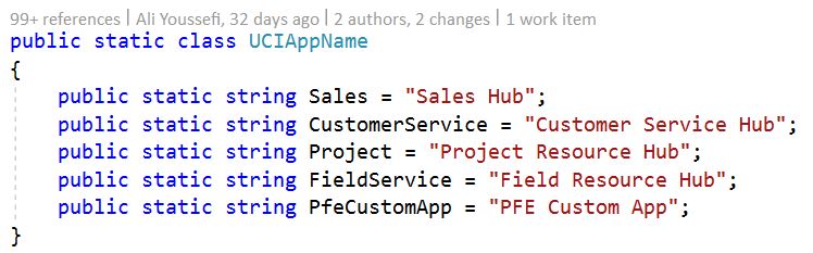

Adding custom UCI applications
In our sample unit test we are navigating to the Sales Hub Unified Interface but there maybe times where you will need to navigate to a specific custom application. A simple way to do so, assuming the UCI app shows in the user's drop down when logged in, is to add to the UCIAppName class.
In the example above a new string has been added to the class called 'PfeCustomApp'. The OpenApp method will search for an UCI app with called 'PFE Custom App'. This can then be used in single or many unit tests.

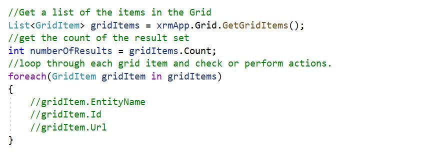

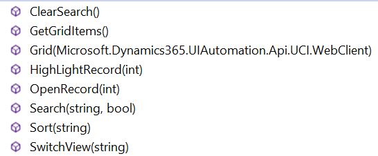

In our sample unit test we knew what to expect due to sample data in our organization. However when implementing your own unit tests you may want perform additional tasks like counting the number of results are returned, sort the records in the view, switch the view, etc.
Above is an image from the Object Browser showcasing the native EasyRepro functionality for the Grid object. To Search use the Search method. For reviewing results look to the GetGridItems method to extract the grid items which we can iterate through.

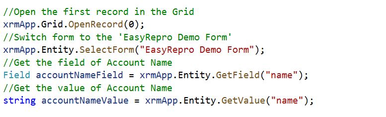

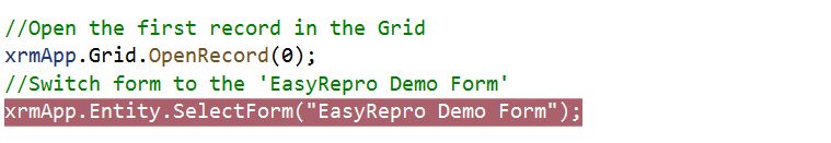

Switching Forms
Start by navigating to the OpenRecord method and adding a new line. Here we will add SelectForm("<name of your form>"). This works with the form selector and allows us to change the form based on the name.
Working with Field Values
When working with most fields on the form the actions a user will perform are to clear out a value, read a value or update a value. In the below image I've added a line using the GetValue method. This returns me the current value which can be used for validation or other concerns. When referencing a field it is important to reference by its schema name and not display name. For instance on Account instead of using 'Account Name' I'm using 'name'.
To clear out a value you simply have to use ClearValue and pass in the schema name.
Finally to set a value you use the SetValue method passing in the schema name of the control (unless working with a complex type field).

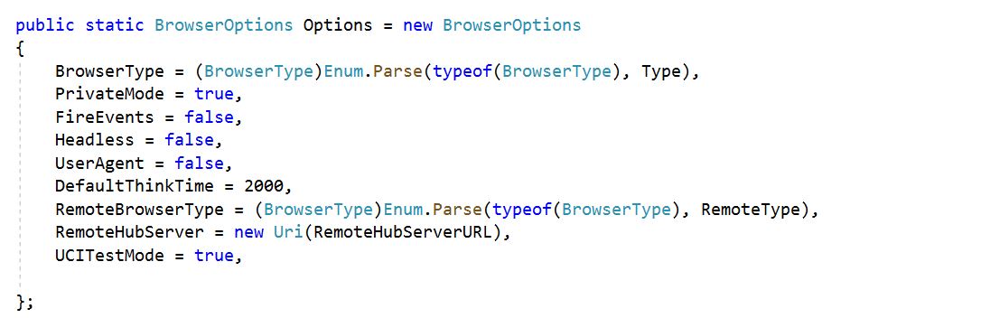

Running Unit Tests in Non Headless Mode
Headless Mode is what tells the unit test if we want to run the test with a GUI or not. Simply stated this will allow us to watch the browser launch and perform the actions or simply run in the background.
In the first post in this series we touched on the TestSettings object and how it tells our unit test how we want it to run. In this object is the class called BrowserOptions and within this is a property called Headless. To turn headless mode on or off, set this value to true (on) or false (off).

Running Unit Tests in Incognito Mode
Going back to the TestSettings object and inside of BrowserOptions we find a property called PrivateMode. By setting this property to true we can run in "Incognito" or "InPrivate" or whateevr terminology your browser of choice uses. This helps us ensure we are using the credentials we provided as well as not assuming any cached settings are applied.

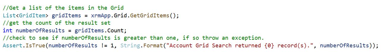

My Unit Test needs to check form or grid values, what can I do?
If you have worked with the Visual Studio Unit Testing tools in the past you are probably familiar with the Assert class. This class allows a test designer to add assertions to ensure the actions performed are accurate. EasyRepro provides us the ability to check for form or grid values and elements which can then be used to with the Assert class.
Using the Assert class
Below is an example of checking if the number of results from our search is not equal to a single result. This could be helpful to determine if duplicates exist as well as other scenarios.
