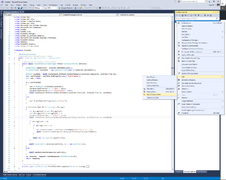

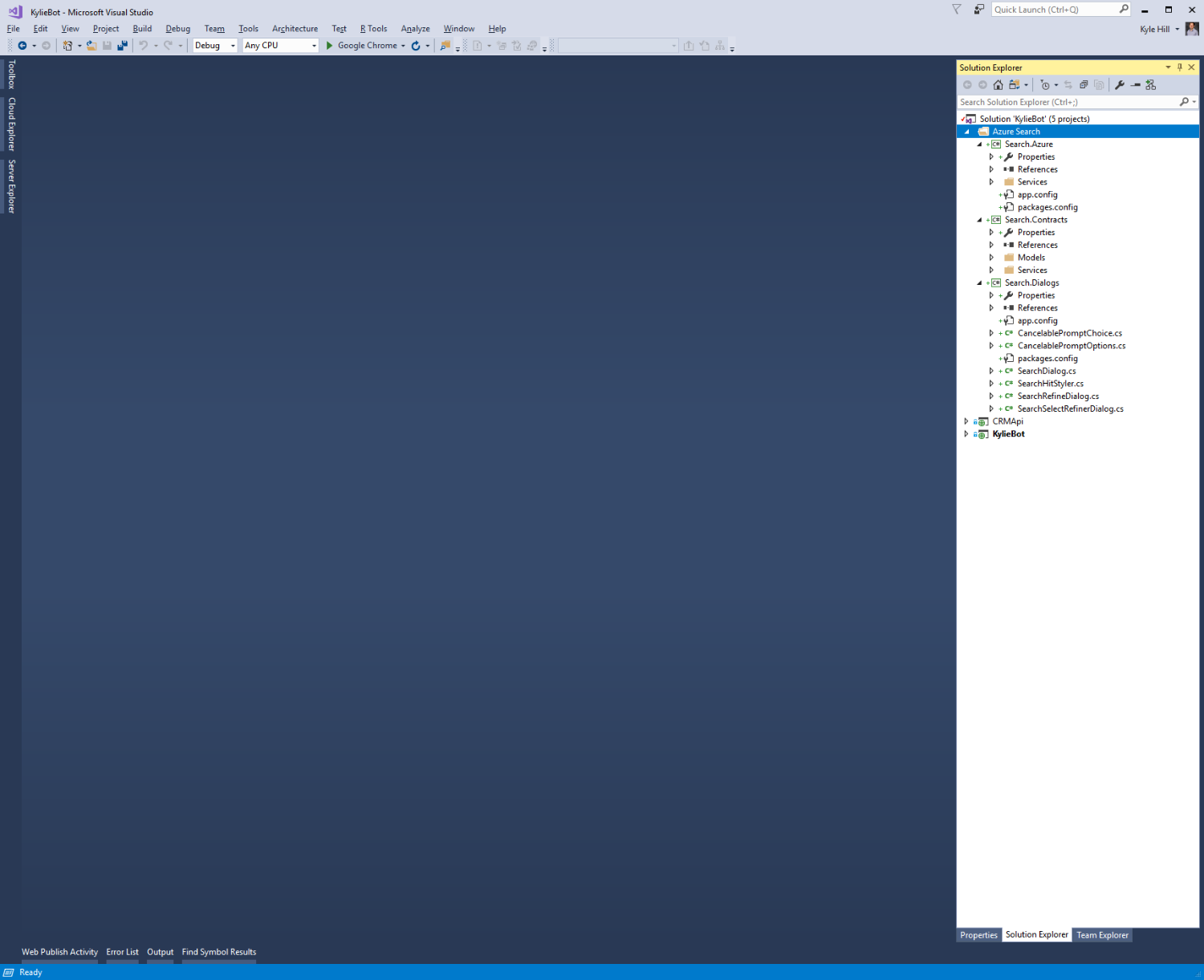

To get started, we are going to add three projects to our solution. These projects will represent the Azure Search capabilities that I mentioned above. To keep the projects grouped, I am going to add a folder to our solution by right clicking on it and selecting ‘Add -> New Solution Folder’ like this:
Next, name the folder ‘Azure Search’ and add the three projects to it. Copies of the projects are available here:
Your solution should now look like this:

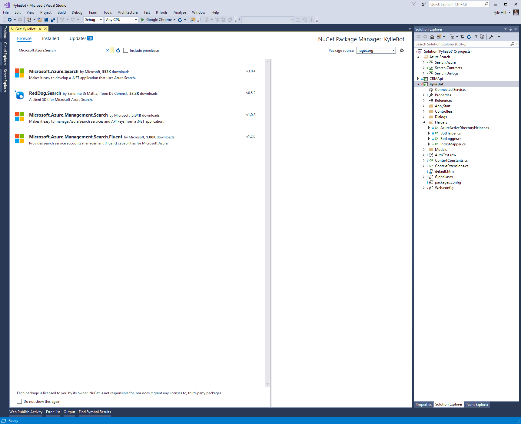

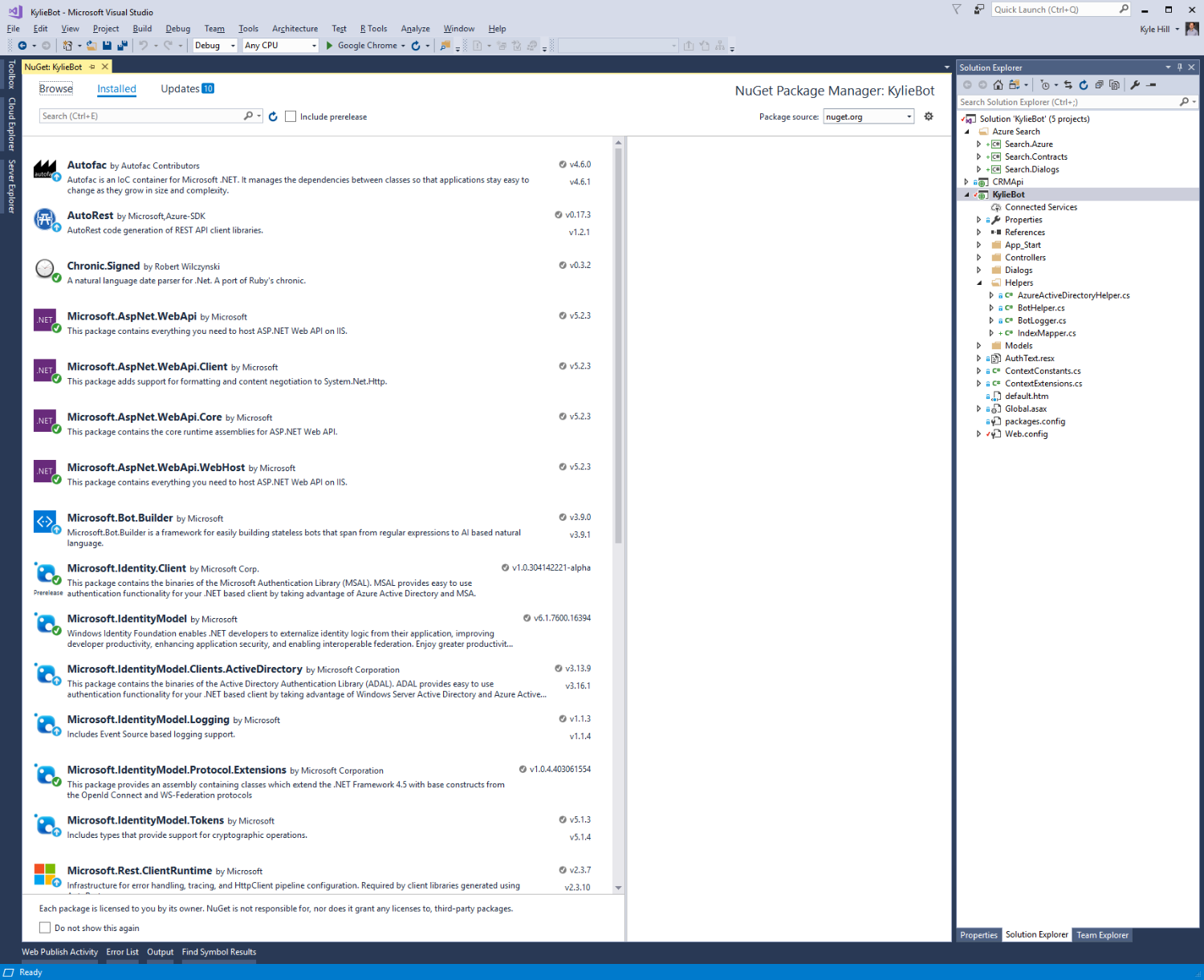

We will also need to add a reference to: Microsoft.Azure.Search. To do this, right click on the KylieBot project and select ‘Manage Nuget Packages…’ and you should see this:
Click on the ‘Browse’ tab in the top left hand corner and then type in Microsoft.Azure.Search and you should see this:

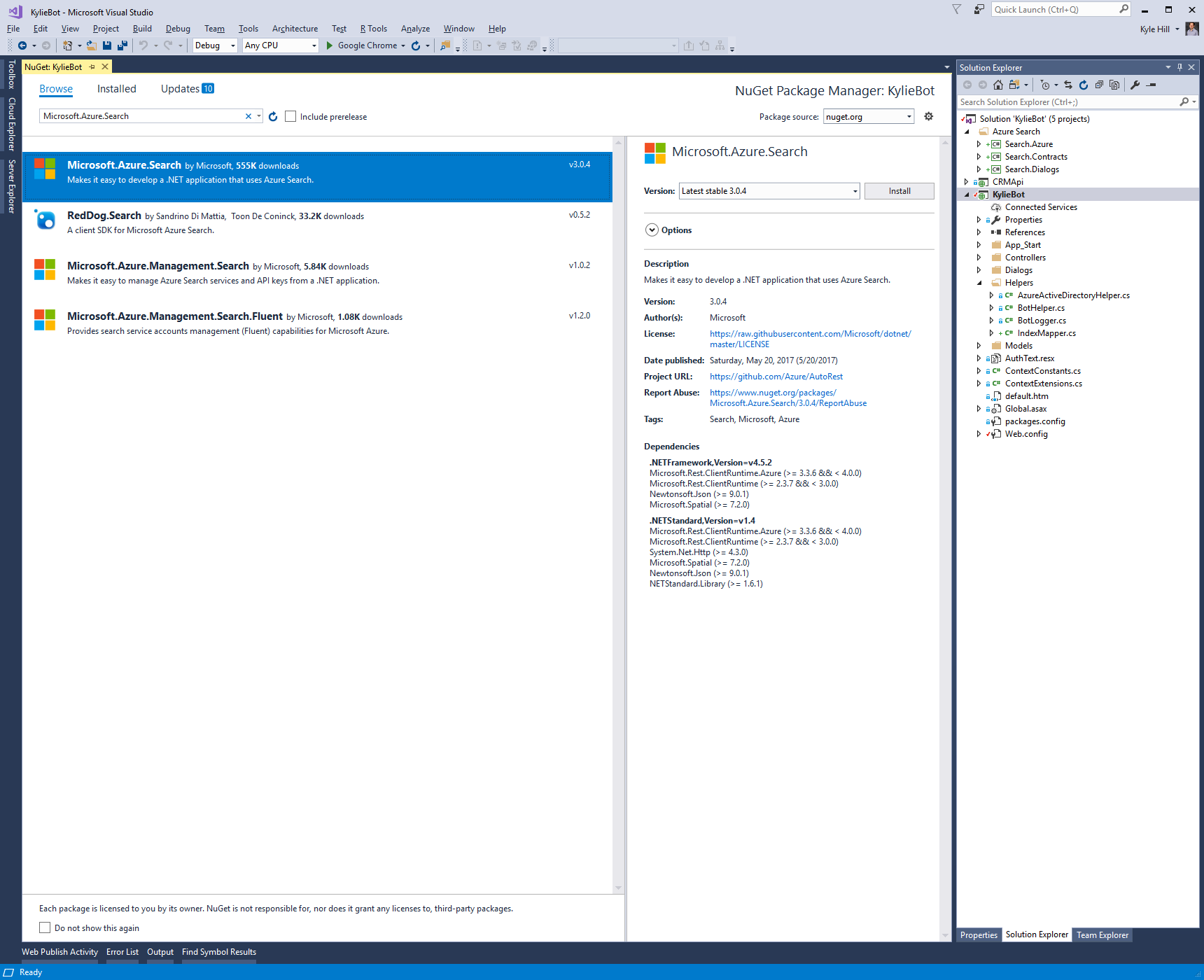

Select the Microsoft.Azure.Search option and the you should see the following:
Click on the grey ‘Install’ button to add the package.

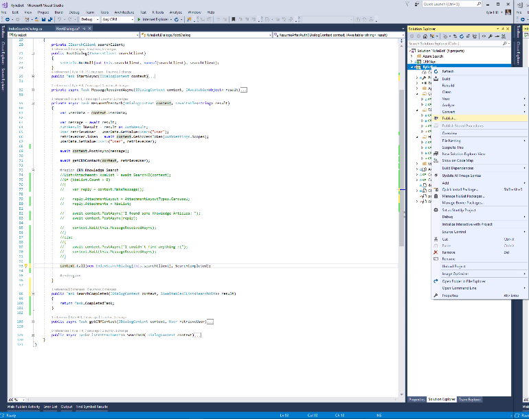

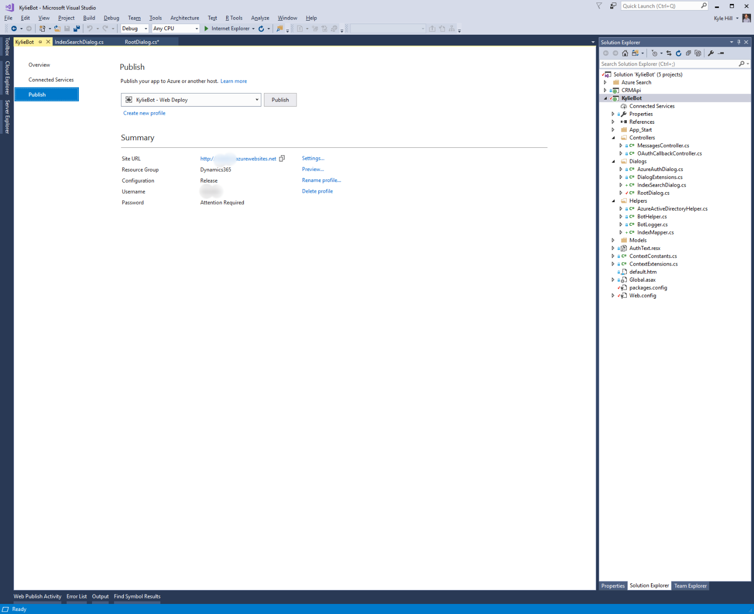

Once this is done, you can go ahead an right click on the KylieBot project and select ‘Publish…’ like this:
The publishing profile should already be stored from our previous deployments and you should be able to click on the ‘Publish’ button like this:

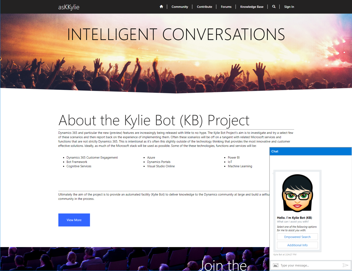

Once the deployment has finished, go and check out the results on your portal where the bot is deployed and you should observe something similar to this:
