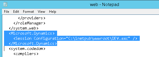

- Assuming the installation at step 3 went through successfully, your next step is to make sure the new site always connects to the right environment. Copy a working AX Configuration file (AXC-file) locally to the server. Make sure it has an updated and correct WCF-configuration in it. I tend to put the file under c:\inetpub\wwwroot\. Give it a good name (like DEV.axc). I know the official documentation says the file can be on a UNC-share, but I never got that to work, so a local file seems to work ok. Finally, you need to put a reference to this file inside the web.config for this particular Web Application. The file is normally located under C:\inetpub\wwwroot\wss\VirtualDirectories\81 (given this application runs on port 81). Open the file in some notepad or text editor and put in a new XML section:
Now you can be sure the Web Application points to the right environment independently of whatever is changed in the business connector configuration settings on this server. I put the section after the System.Web section. - Finally, I recommend loading the site itself and edit the Site Permissions. You probably want to make sure either Domain Users or some dedicated AD User Group has at least Read permissions.
