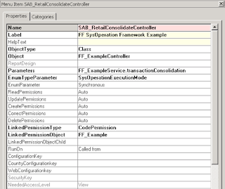

Create a new action menu item;
Create new action menu item with following properties set as shown;
This menu item is calling controller class with parameters ServiceClass.MethodName with execution mode. If you see the Main method of controller class it is getting these passed parameters in this piece of code and eventually calling transactionConsolidation method of Service class.
[className, methodName, executionMode] = SysOperationServiceController::parseServiceInfo(args);
    controller = new FF_ExampleController(className, methodName, executionMode);
