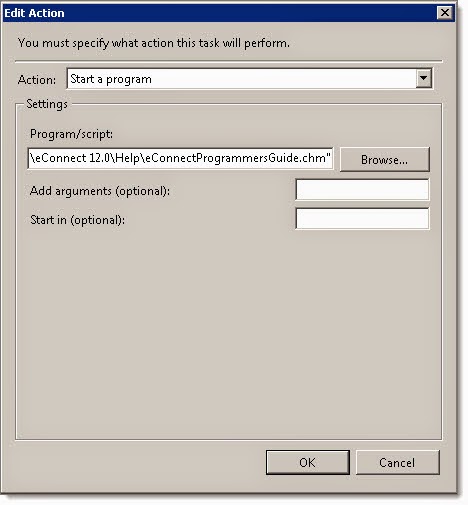

To validate this, I performed a simple test. I setup a new task in Windows Task Scheduler that would simply launch the Dynamics GP eConnect Programmers Guide, which is a .chm help file. I did this because Task Scheduler allows you to run an application in your user session, or as a system task that does not require you to be logged in--this runs it in a "nether world" similar to running as a Windows Service.
When I chose the option to "Run only when a user is logged on", the HHCTRL message did not appear in Event Viewer. But when I chose "Run whether a user is logged on or not", an HHCTRL message DID appear in Event Viewer.
We had found the cause of the problem: If a Windows application that uses HTML Help attempts to run as a Windows Service or other type of background process (such as with Task Scheduler) that is NOT in a Windows user session, the security restrictions in HTML Help prevent it from working. When this happens, Event 1903 is logged to the Application event log. That, in concept, is not a problem.
