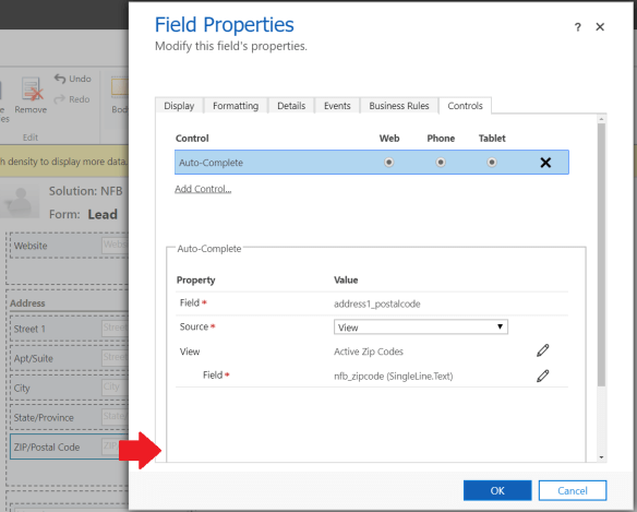

I configured the address1_postalcode field using the auto-complete control on the form. This control allows admins to ‘point’ a single line of text field to values in either an entity related option set type of field or values in an entity view. (What this means is that the single line of text field kinda turns into an option set type of field.)
When you configure the control to use a view you have to define the entity you want to use and the entity view. Obviously I choose to use a view and I selected the ‘Zip Codes’ entity and the ‘Active Zip Codes’ view. Lastly I needed to select the field of the view’s primary entity to use as the data source. This will normally be the primary entity field, which I had renamed from ‘name’ to ‘zip code’ when I created the entity.

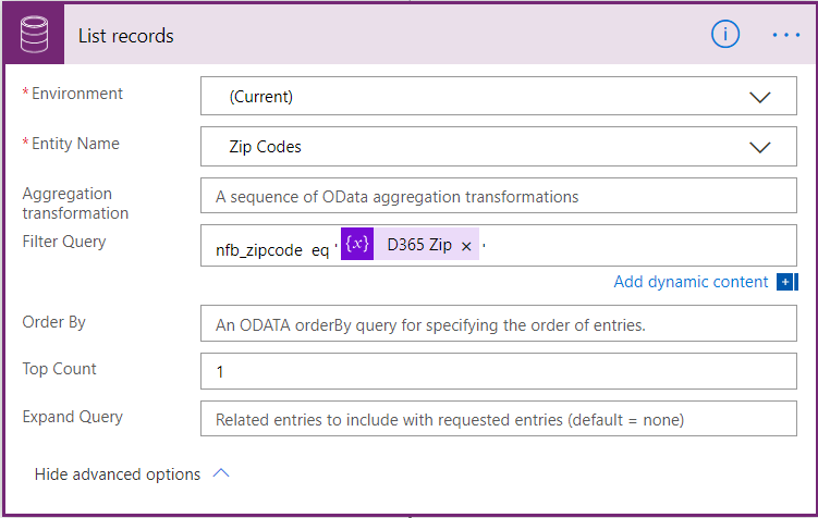

The next step in this flow is ‘list records’ (common data service). In this step we are querying the Dynamics 365 data base. We will be using the zip code that was entered in the lead record as a filter. Since we are looking for zip code records, that’s what we enter as the entity. Under filter query, I typed the primary field of the entity (in my case ‘nfb_zipcode’) then ‘eq’ and then I picked the variable D365 Zip. Make sure you use single quotes around the variable! We are only expecting to get one record in the query, so set the top count to 1. Below is an example of what this looks like.
