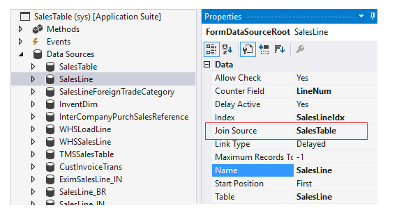

E.g. if you have SalesTable and SalesLine and want to link them together in a form, you only need to do the following:
- Make sure the relation to the parent table (SalesTable) exists on the child table (SalesLine).
- Set SalesTable as a related table on SalesLine data source in a form.
Once you have it, the data sources will be linked dynamically.

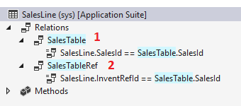

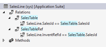

What if we have multiple relations between the same tables for the different purposes?
SalesLine has two relations to SalesTable in the standard code. How does the system know which relation to pick?
I noticed that it selects the topmost relation to the related table. So, if you have two, it will select the first one in the relations list. In this case, relation #1 in the screenshot as it is above #2.
What if suddenly #2 moves to the top?

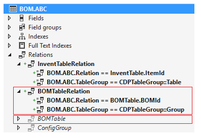

Let me show you one recent example that I had with BOM and BOMTable.
One field was an enum TableGroup and the other one was named Relation which contain values based on TableGroup field.
If the value Table is selected in TableGroup field, then the Relation field would show Items, if the value Group is selected, then it would show BOMs.
To get the lookup right, I created a couple of relations. One to the InventTable and another one to BOMTable.
Notice that BOM have already had relation to BOMTable. In the extension, I created another relation to the BOMTable, which overruled the other relation as it was topmost now. And I could not bring it down below the standard relation.
This broke the BOMTable form and all other forms that relied on this relation. Now tables BOMTable and BOM are dynamically linked using new relation which is incorrect and results in wrong outcome shown on the form.
