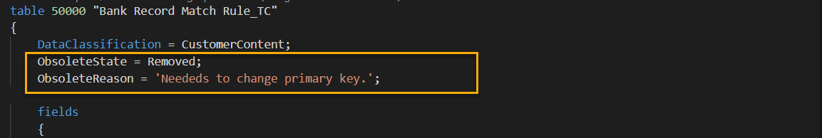

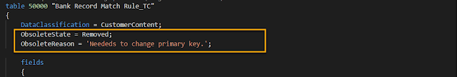

How to make a field or table obsolete?
If you want to obsolete the entire table then you can add Obsolete Status and Reason just like below.
If you want to obsolete the field, then you need to add the status and reason as below.
Once you do that just make sure to handle the data upgrade as well. You need to write a small codeunit to upgrade the data from your old table/field to the new table/field.
