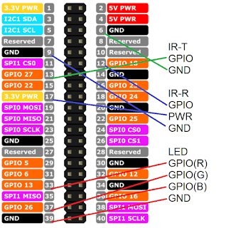

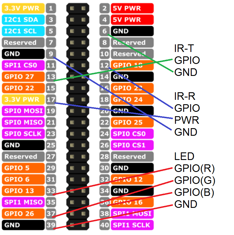

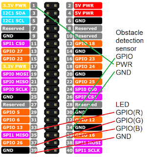

As you can see from the code above I utilized GPIO Pin to collect info from Obstacle detection sensor
Please see the connection details for Variation 1 using 1 sensor below
GPIO 12 <-> OUT
3.3V <-> +
GND <-> GND
LED
GPIO 13 <-> R
GPIO 26 <-> G
GPIO 16 <-> B
GND <-> -
Connections
<![if !vml]> <![endif]>
Implementing Variation 1 using 1 sensor is pretty straightforward: all you need to watch for is when the signal level changes on Obstacle detection sensor GPIO Pin

Graph
As you can see from the code above I utilized GPIO Pins to control Infrared transmitter and Infrared receiver sensors
Please see the connection details for Variation 2 using 2 sensors below
GPIO 27 <-> S
GND <-> -
Infrared receiver
GPIO 18 <-> S
3.3V <-> +
GND <-> -
LED
GPIO 13 <-> R
GPIO 26 <-> G
GPIO 16 <-> B
GND <-> -
Connections

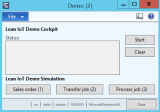

Finally we're going to create a Lean IoT Demo Cockpit for self-driven demo. Similar to Workflow processor Demo form in standard Microsoft Dynamics AX 2012 R3
This is how this form looks like
Demo
Start button begins the simulation process and Sales order demand will be automatically introduced based on timer. Stop button stop the simulation process. Clear button wipes Demo Staging table with Demo transactions
Clear
Please note that I introduced Demo Staging table to hold the data about what has been simulated. Thus IoT device will only see demand which has been simulated by Lean IoT Demo Cockpit

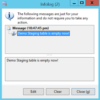

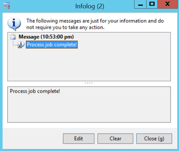

Now let's begin the simulation by pressing Start button
Infolog

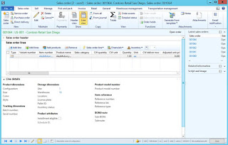

Infolog pops up indicating that Sales order demand has been introduced and the entire pegging tree was planned for Sales order line.
Sales order
Pegging tree
At this point I can use IoT device and replenish/pick products to/from Part location – and this will be reflected in Microsoft Dynamics AX 2012 R3 in form of completed Transfer or Process jobs.
When I physically put a part into Part location Transfer job will be completed automatically and the light will light up with Green indicating that the location is Full
Transfer job
Pegging tree
We can also verify the status of Transfer job which changes to Completed
When I physically pick a part from Part location Process job will be completed automatically and the light will light up with Red indicating that the location is Empty
Process job
Pegging tree
We can also verify the status of Process job which changes to Completed
During the simulation execution you can also review the results in real time
Cockpit
Note: Connection with IoT device is done by means of Web Services. Then IoT device reports completion of Transfer and Process jobs.
Infolog

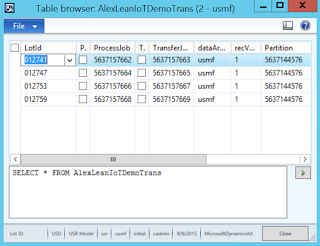

Behind the scenes records in Demo Staging table get populated and updated
Demo Staging table
As you interact with IoT device putting and picking parts to/from Part location appropriate Transfer and Process jobs will automatically be updated/completed in Microsoft Dynamics AX 2012 R3
