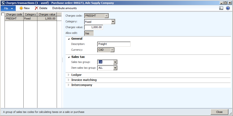

1. For header level charges, Go to purchase order --> on the action pane, on the purchase tab, in the charges group, click on maintain charges.
OR
1. For line level charges, go to purchase order --> Purchase order lines --> Select particular purchase order lines --> Click on Financials --> under charges --> Click on maintain charges
2. Select charge code which we have created.
3. Select the category. (It can be fixed, percentage or inter-company percentage etc.)
4. Select the charges value. (In case of Fixed, enter the amount of charges / In case of percentage, enter the percentage for charges)
5. You can assigned sales tax group and item sales tax group if you want sales tax to get calculated for the charges.

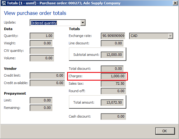

6. Once the charges are setup against the purchase order, click on Total to see the charges.

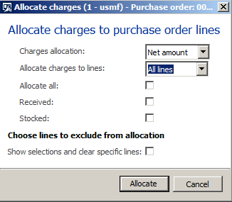

Allocate charges
1. It is used to allocate charges to purchase order lines by selecting various parameter in the Allocate charges form.
2. Go to purchase order --> on the action pane, on the purchase tab, in the charges group, click on Allocate charges.
3. Charges allocation: It can be
          Net amount: Charges are allocated based on the each line amount relative to total net amount for the purchase order or invoice.
          Quantity: Charges are allocated based on the number of units for each line relative to total number of units for the  purchase order / invoice.
           Per line: charges are allocated equally among the total number of lines. For example: if the charge value is 500 and there are 5 lines in the purchase order then amount 100 will get distributed amount 5 lines in the purchase order.
4. Allocate charges to lines
         All lines: It will allocate charges to all the lines on the purchase order.
         Positive lines: It will allocate charges only to lines with positive amount.
         Negative lines: It will allocate charges only to lines with negative amount. For example: If we want charges to get incurred while returning goods to the vendor then we can select this option.
5. Allocate all
It will allocate charge to PO lines even if charge code has debit type other than Item.
6. Received
In this charges are allocated to the lines based on the quantity that has been received for each line.
7. Stocked
It is for the stocked items. Charges will get allocated only to stocked order lines.

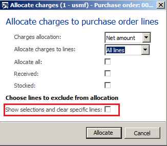

8. Show selection and clear specific lines:
   a. This check box only enables if charges have been setup in the order.
b. Ticked show selections and clear specific lines check box.

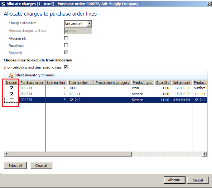

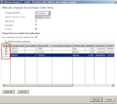

  c. Based on the criteria selected in the Allocate charges to lines and stocked fields, it will show the liens in the grid.
  d. For example: if the criteria selected is Positive lines and stocked then system only show positive stocked lines.
  e. Clear the Include check box to exclude the lines from allocation of charges.
  f. Click on Allocate to allocate charges to the selected lines.
  g. Once the charges have been allocated, go to purchase order --> on the action pane, on the purchase tab, in the charges group, click on Maintain charges.
  h. You can see empty form as charges have already been allocated between the lines in the order.
  i. Go to Purchase order Total --> you can see amount of charges allocated in the order.
