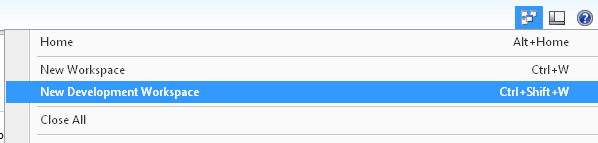

The AOT can be accessed by opening a new Development Workspace by clicking Ctrl + Shift + W or by navigating to Windows > New Development Workspace in the upper right hand corner of the screen. Only people with certain security rights can get to the AOT, so unless you have been given Sys Admin rights to your AX environment, do not worry about accidentally opening the AOT.
Access the AOT by selecting Windows + New Development Workspace or Ctrl + Shift + W
Navigating to Windows > New Development Workspace will open the AOT
