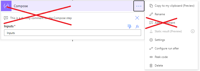

This is not about how to add comments to the flow steps.

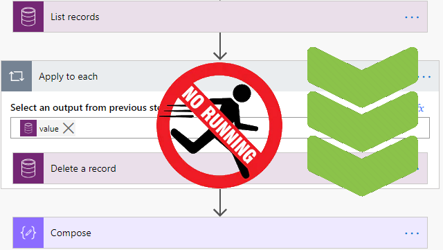

Another scenario is when I need to test the last part of a long running flow and I want to disable the long running process, skip that middle part, mock the data and only test the last part repeatedly.

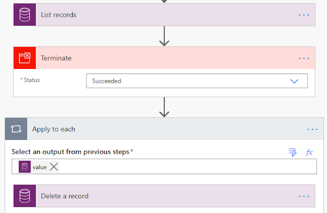

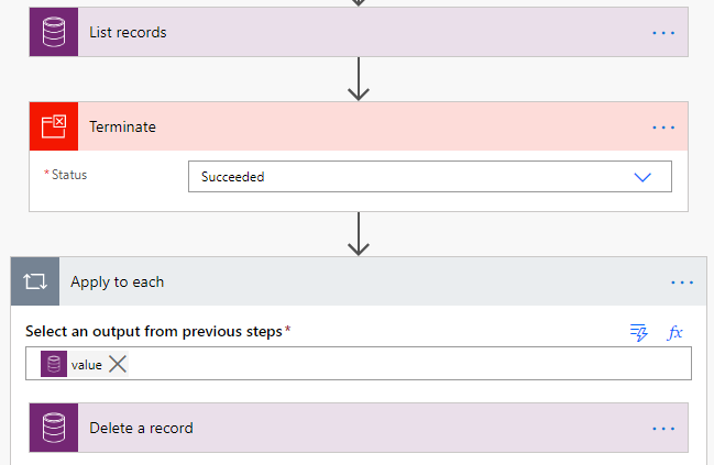

Using the Terminate Action
If the steps that you want to disable are at the end of the flow, you can configure your flow so it would not reach the last step  by adding the Terminate step with Succeeded status before it reaches the last steps. That is equivalent to "unreachable code after return statement" in the normal programming.
function f() {
var x = 1 + 2;
return;
x = 3 + 4;

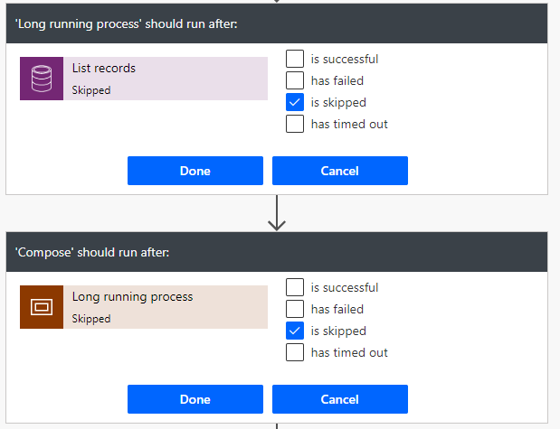

Using Configure run after
When the steps that you want to skip is in the middle of the flow, you can bundle all of those steps in a Scope control. After that, set the "Configure run after" of the Scope control to "is skipped" or "has timed out" and set the step afterwards as "is skipped" too. You can read more details at this blog post by Pieter Veenstra.

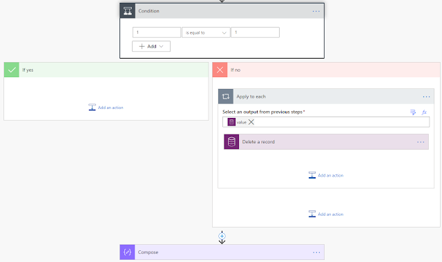

Using Condition control
You can also use the Condition control to skip the steps you don’t want to execute. All you have to do is add a Condition control with dummy condition (e.g. 1 = 1) then move the steps that you do not want to run into the negative branch of the flow and the flow will just skip those steps in every run.

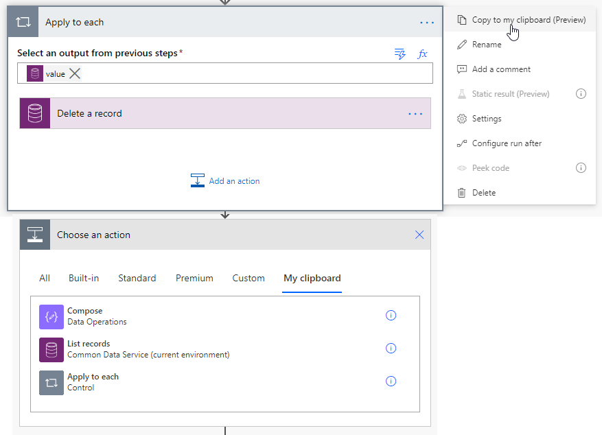

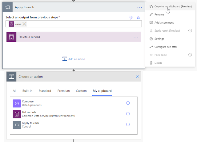

Using Copy to my clipboard
This method is by temporarily deleting the steps from your flow but copying into the clipboard before the step is deleted. This allows you to add the steps back from the clipboard once you are completed with the debugging. However, with this method, there is a risk of losing the steps in the clipboard if the flow designer browser tab crashed or the browser is closed by accident.
