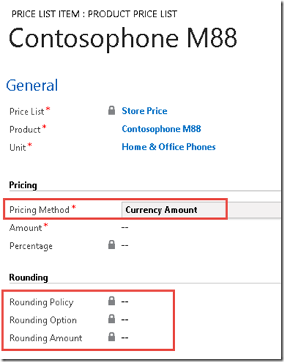

Rounding Policy option will be available if only you use the Pricing Method other than Currency Amount, because, other methods are using percentage, not an exact amount like in the Currency Amount.
Let’s get started.
Rounding Policy will not be available to choose if the Pricing Method is using Currency Amount

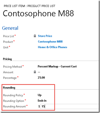

Let’s we choose the Up as the Rounding Policy.
Ends in
I set:
Rounding Policy to Up
Rounding Option to Ends In,
Rounding Amount to $15

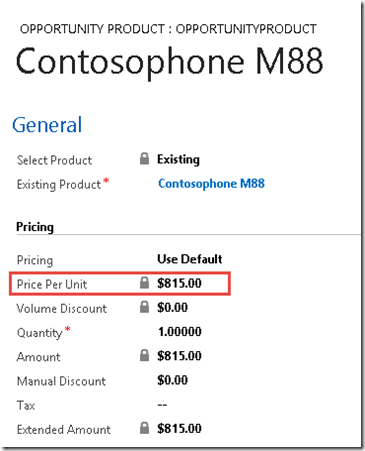

Now here is the result:
Why $815?

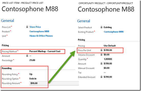

Let’s get another settings:

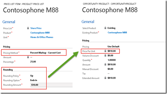

I set the amount to $15, $10, and $99
And see the result
$10

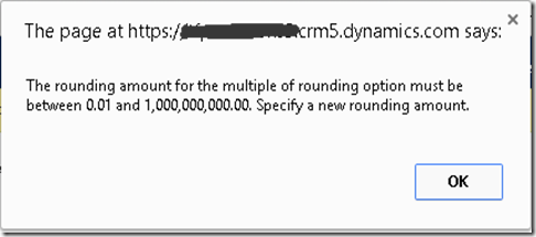

*But, you cannot set to 0, you will receive this error message.
So, I add the 0.01 as the lowest one.
