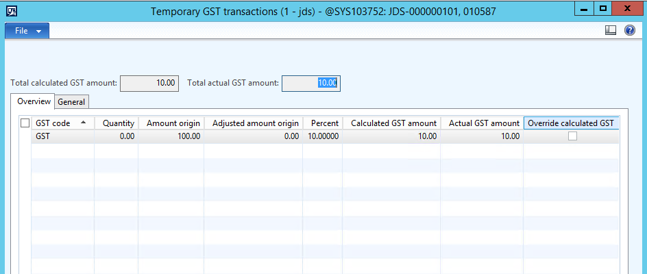

So now when you open the form , you will notice that Tab Adjustment is not available :

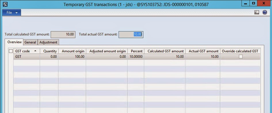

this will make sure that we are having Adjustment tab on same form :
