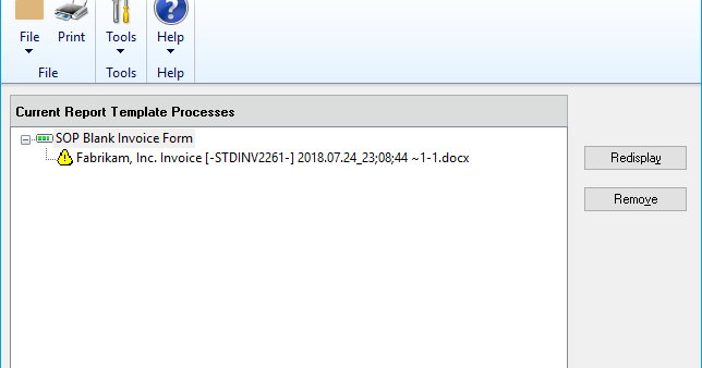

    The file type is based on the file type selected for that vendor, usually .docx but .pdf and .xps are also options in that setup screen. I have seen GP create the documents in a subfolder below the TEMP directory, usually typing %TEMP% into the Windows Explorer address bar will get you to the same folder that GP is using. Here's a variety of next steps I would consider:
    • Double check the %TEMP% folder for docx, pdf, or xps files after the user generates the remittance
    • Can you "Print Remittance" instead of emailing? If it won't print the Word document to screen, it will not be able to email either
    Payables Management in Dynamics GP - Dynamics GP | Microsoft Learn
    • Watch the "Templates Processing" bar at the bottom of GP to see if the files are generating successfully (or even trying to generate when emailing)
