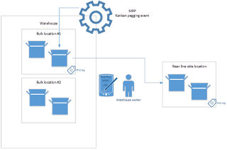

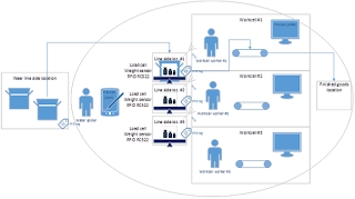

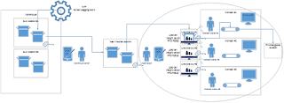

Here's the conceptual diagram of the process
Diagram
<![if !vml]> <![endif]>
Diagram – WMS point of view
Diagram – Lean manufacturing point of view

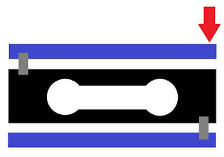

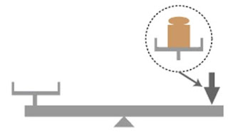

Principle
In this experiment I'll use so called "single point load cell" as depicted above. Its working principle is that when you fix one side and apply a force on another side load cell will undergo a deformation process causing a difference in voltages which we can measure and ultimately make a decision about weight put on the "scale".
Please see diagrams below for more details
Conceptual principle
Physical setup

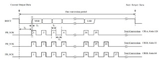

Weight sensor HX711 is a precision 24-bit analog-to-digital converter (ADC) designed for weigh scales and industrial control applications to interface directly with a bridge sensor.
Pin SCK and DT are used for data retrieval, input selection, gain selection and power down controls. When output data is not ready for retrieval, digital output pin DT is high. Serial clock input SCK should be low. When DT goes to low, it indicates data is ready for retrieval. Input and gain selection is controlled by the number of the input SCK pulse.
Table (gain values)
Setting up gain factor allows to convert number of impulses into a weight.
This is how impulses measured by weight sensor look like when applying weight on a load cell
Diagram
SCK (PD_SCK): Serial Clock Input
DT (DOUT): Serial Data Output
Weight sensor has multiple internal registers. Please note that no programming is needed for the internal registers. All controls to the HX711 are through the pins.

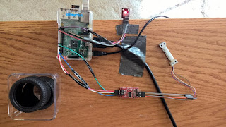

Please see my physical setup using load cell and weight sensor on the picture below

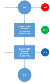

In order to better visualize the results I also introduced LED which lights up with different colors depending on weight applied on a load cell. Please see the diagram below for more details
Diagram (Handling different quantities)
In my experiment I didn't convert number of impulses into a weight, instead for simplicity I determined experimentally a number of impulses which corresponds to a particular quantity. For example, average 5 impulses correspond to quantity of 2, 6 – to quantity of 1 and 7 – to none. Also to avoid fluctuation errors I introduced ranges within which measurements may vary: ( ; 5.5) |- Qty = 2; [5.5; 6.5) |- Qty = 1; [6.5; ) |- Qty = 0.

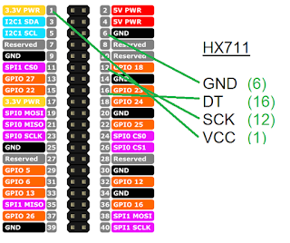

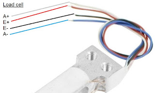

As you can see from the code above I utilized GPIO Pins to collect info from weight sensor
Load cell <-> HX711
Red <-> E+
Black <-> E-
White <-> A+
Blue <-> A-
HX711 <-> RPi
GND <-> GND
DT <-> GPIO 23
SCK <-> GPIO 18
VCC <-> 3.3V PWR
Connections (Load cell)
Connections (HX711)

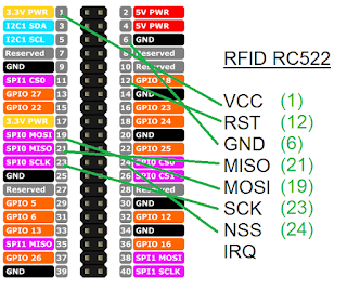

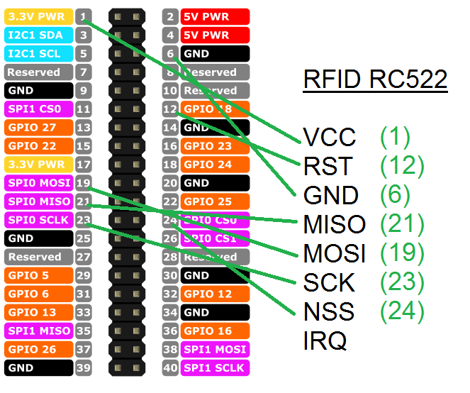

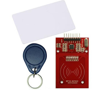

In order to handle different products in the same location I'll use RFID RC522 sensor. Essentially RFID sensor has its own antenna and it is capable of sending and receiving signals to detect RFID tags in proximity.
This is what we are going to use specifically in this experiment
Principle
The MFRC522 supports direct interfacing of hosts using SPI, I2C-bus or serial UART interfaces. A serial peripheral interface (SPI compatible) is supported to enable high-speed communication to the host. The interface can handle data speeds up to 10 Mbit/s. When communicating with a host, the MFRC522 acts as a slave, receiving data from the external host for register settings, sending and receiving data relevant for RF interface communication.
MFRC522 inputs/outputs
Technically RPi allows to have one master (RPi itself) and 2 slaves communicating with master through SPI. For the sake of simplicity we'll implement one master – one slave model where RPi itself will be master and RFID RC522 will be slave
One master (Raspberry Pi) and one slave (RFID RC522)
This is how generated impulses look like depending on the mode of operation
Diagram
SCK (SCLK): Serial Clock
MOSI: Master out slave in
MISO: Master in slave out
CS (SS, NSS): Chip select
RFID RC522 has multiple internal registers. Please note that programming will be needed to write driver for RFID RC522 and be able to read and write data from/to internal registers. Then we can communicate with RFID RC522 via SPI pins.
Before you can use SPI interface it has to be initialized as shown below
Source code

The easy way to test the connection to RFID RC522 is to retrieve its firmware version. For example, getFirwareVersion method below will return the version of firmware for RFID RC522.
Source code
private byte getFirmwareVersion()
    byte version = readMFRC522(VersionReg);
    return version;
private byte readMFRC522(byte register)
    byte[] writeBuffer = new byte[2] { Convert.ToByte(((register << 1) & 0x7E) | 0x80), 0x00 };
    byte[] readBuffer = new byte[2];
    spiRFID.TransferFullDuplex(writeBuffer, readBuffer);
    return readBuffer[1];
According to RFID RC522 spec VersionReg register is responsible for storing firmware version, its address is 0x37 (binary: 00110111). In order to retrieve a firmware version from VersionReg register we need to send a packet in a way suited for data read over SPI. As shown above bit1 should be set to 1, then bit2 through bit7 will contain register address and finally bit8 will be set to 0. The following expressing will format the packet appropriately for data read from VersionReg register over SPI:
((0x37<<1) & 0x7E ) | 0x80
Let's review in details the outcome of this expression. Looking at binary values will help us understand what's going on
((0x37<<1) & 0x7E ) | 0x80  (hexadecimal representation)
((00110111<<1) & 01111110) | 10000000 (converted all values to binary)
(01101110 & 01111110) | 10000000 (applied bit shift)
01101110 | 10000000 (applied AND operation)
11101110 (applied OR operation)
As the result we have 11101110. Please note that bit1 is set to 1 for read, then bit2 to bit7 contain VersionReg register address (110111 = 00110111 or 0xEE) and finally bit8 is set to 0. This will form the first byte of data we should send over SPI, the second byte of data for read should be 0 (00000000 or 0x00). Thus 2 bytes of data we will send to VersionReg register in order to retrieve version of the firmware will be: {0xEE, 0x00}.  Please note that in a full duplex mode we'll send 2 bytes of data over SPI as a command and retrieve 2 bytes of data simultaneously in response. First byte received will indicate success of the operation (decimal 0 for success, decimal 2 for failure) and the second byte will actually contain a version. The values retrieved in the second byte may be 0x91 for version 1 and 0x92 for version 2. In my case firmware version was version 2.
Similarly the following expression will be used to format a packet appropriately for data write
(RegisterAddress<<1) & 0x7E

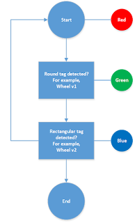

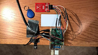

Please see my physical setup using RFID sensor on the picture below
In order to better visualize the results I also introduced LED which lights up with different colors depending on type of product placed in the location. Please see the diagram below for more details
Diagram (Handling different products)
Please note that RFID tags can come handy not only to detect product type but also to detect employees based on their badges

                    if (serialNumber[0] == 0xB4)//Round tag = Green
                        pinR.Write(GpioPinValue.Low);
                        pinG.Write(GpioPinValue.High);
                        pinB.Write(GpioPinValue.Low);
                    else if (serialNumber[0] == 0x7E)//Rectangular tag = Blue
                        pinG.Write(GpioPinValue.Low);
                        pinB.Write(GpioPinValue.High);
                    else
                        serialFound = false;

Please note that I've implemented a required minimum code to retrieve RFID tag serial numbers which includes isCard and readCardSerial methods. I didn't implement halt method which would reset RFID card reader, instead I'm calling init method. In init method there're 2 behaviors possible: 1) last applied RFID tag is retained; 2) last applied RFID tag is forgotten. That's why I have 2 lines of code one of which is commented 1) Green -> Blue -> Green; 2) Green->Red; Blue->Red. The code above implements 2nd behavior.
Serial numbers for RFID tags are 5 bytes long and in my case they are the following:
<![if !supportLists]>-          <![endif]>Round tag: 180 92 120 164 52 (0xB4 0x5C 0x78 0xA4 0x34)
<![if !supportLists]>-          <![endif]>Rectangular tag: 126 87 251 229 55 (0x7E 0x57 0xFB 0xE5 0x37)
Please note that in the code above I determine which tag has been selected by checking just the first byte of its serial number (0xB4 for round and 0x7E for rectangular)
RFID RC522
VCC <-> 3.3V PWR
RST <-> GPIO 18
GND <-> GND
MISO <-> SPI0 MISO
MOSI <-> SPI0 MOSI
SCK <-> SPI0 SCLK
NSS <-> SPI0 CS0
IRQ (Not connected)
Connections
Please review the following video describing how RFID sensor is used for this scenario: http://1drv.ms/1jLLZEr
As a reference point you can also find RFID RC522 Arduino libraries in the internet

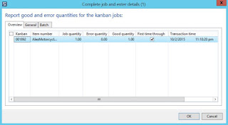

Complete with details function allows to specify Good and Error quantities when completing Manufacturing kanban. This comes handy when you need to complete partial quantity for Manufacturing kanban.
Kanban board for process jobs
In standard Microsoft Dynamics AX 2012 you can complete Manufacturing kanban Process job in a silent mode or using interactive form where you can specify different Good and Error quantities. In order to automate Complete with details function I've added automatic mode of execution (Automatic) meant for integration

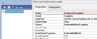

KanbanMultiMode enum
For interactive mode the following action menu item is used (EnumTypeParameter = KanbanMultiJobComplete, EnumParameter = Form)
KanbanJobComplete menu item
For silent mode the following action menu item is used (EnumTypeParameter = KanbanMultiJobComplete, EnumParameter = Silent)
KanbanJobCompleteSilent menu item
Please see the source code for Complete with details function automation below

    kanbanBoardTmpProcessJob.insert();
    /* Tmp */
    args.record(kanbanBoardTmpProcessJob);
    //args.caller(kanbanMultiJob);
    args.parmEnumType(enumnum(KanbanMultiMode));
    args.parmEnum(KanbanMultiMode::Auto);
    autoMap = new Map(Types::Int64, Types::Container);
    autoMap.insert(kanbanBoardTmpProcessJob.Job, [kanbanBoardTmpProcessJob.QuantityOrdered, 0]);
    KanbanMultiJob::newArgs(args, LeanKanbanJobStatus::Completed).runAuto(autoMap);
    info("Done!");
Please note that this function allows to complete multiple jobs at once, that's why I introduced additional parameter of type Map (Job <-> Container of quantity values) and passed it to a newly created method runAuto where appropriate Good and Error quantities will be set up for update

Please see below how I introduced Automatic mode of operation in addition to Silent and Form modes
Source code (Classes/KanbanMulti)
public static KanbanMultiMode kanbanMultiMode(Args _args)
    KanbanMultiMode kanbanMultiMode;
    if (   _args
        && (_args.parmEnumType()  == enumnum(RunChoose)
        ||  (_args.parmEnumType() == enumnum(KanbanMultiMode)
        &&   _args.parmEnum()     == KanbanMultiMode::Form)))
        kanbanMultiMode = KanbanMultiMode::Form;
    else
        //alex:>>
        if (_args.parmEnumType() == enumnum(KanbanMultiMode) &&
            _args.parmEnum()     == KanbanMultiMode::Auto)
           kanbanMultiMode = KanbanMultiMode::Auto;
        else
            kanbanMultiMode = KanbanMultiMode::Silent;
        //alex:<<
    return kanbanMultiMode;
