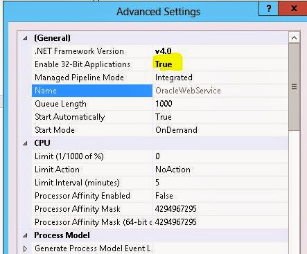

Solution:
After some troubleshooting, found the fix is to set Enable 32-bit Application = True on the App Pool which is used by the webservice. This solved the problem.
