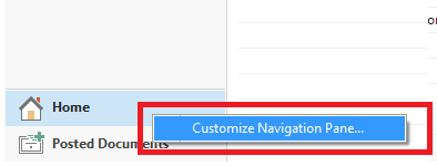

Next question is how are we going to remove these views??
It is pretty easy. Right click on the navigation pane and select "Customize Navigation Pane"
In the window that gets open you will be able to see the saved view or views that you have been created. Select them and remove them from the pane or delete them and click ok.
