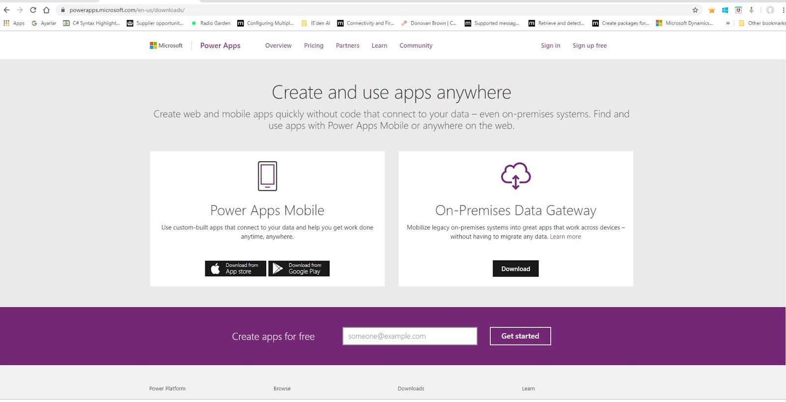

4-  Microsoft On-Premises Data Gateway Guide
a- Download the app from https://powerapps.microsoft.com/en-us/downloads/
Screen 1 - Microsoft On-Premises Data Gateway Download
b- Double click GatewayInstall.exe to start installation

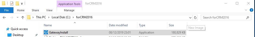

Screen 2 - Open File

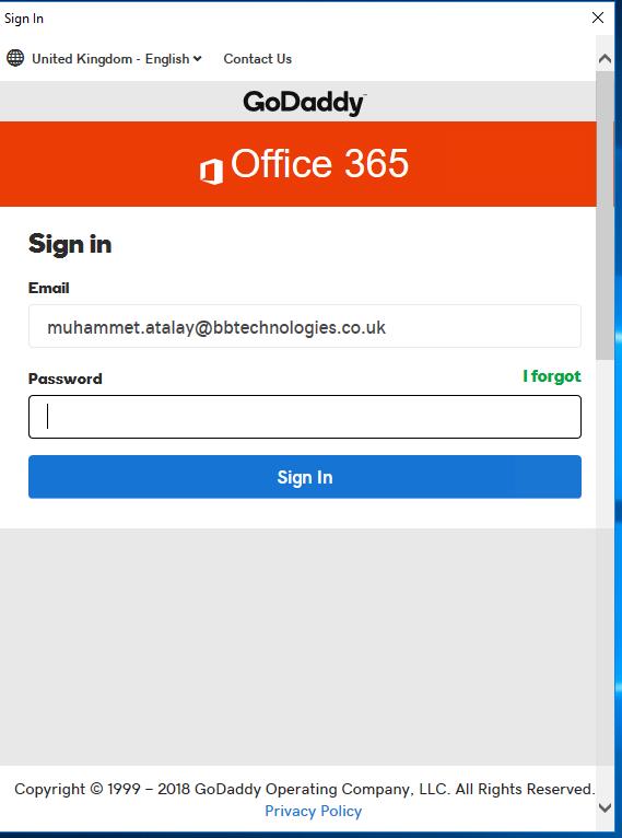

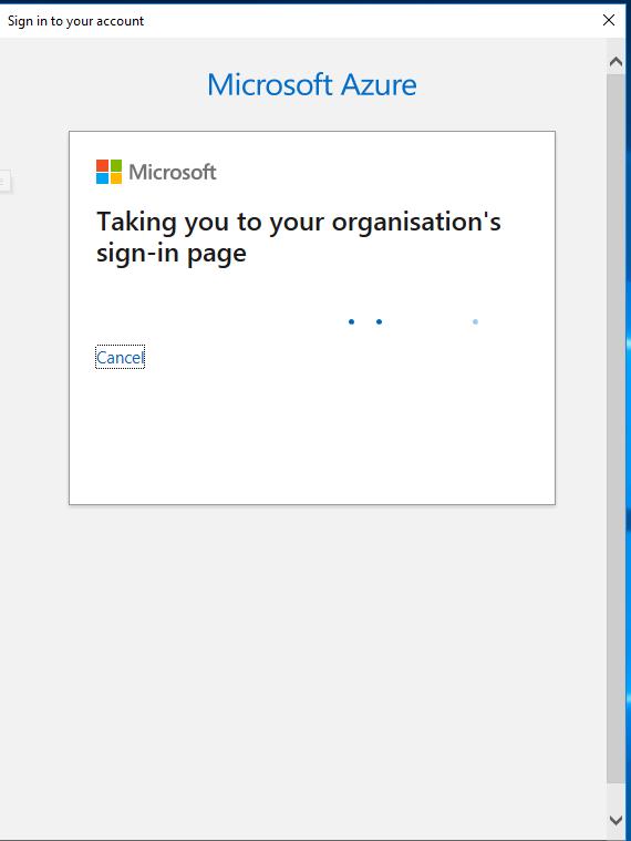

i - Login to the platform.
Screen 9 - Sign In
j- Your are redirected to the federation services for successfully login.
Screen 10 - Forwarding

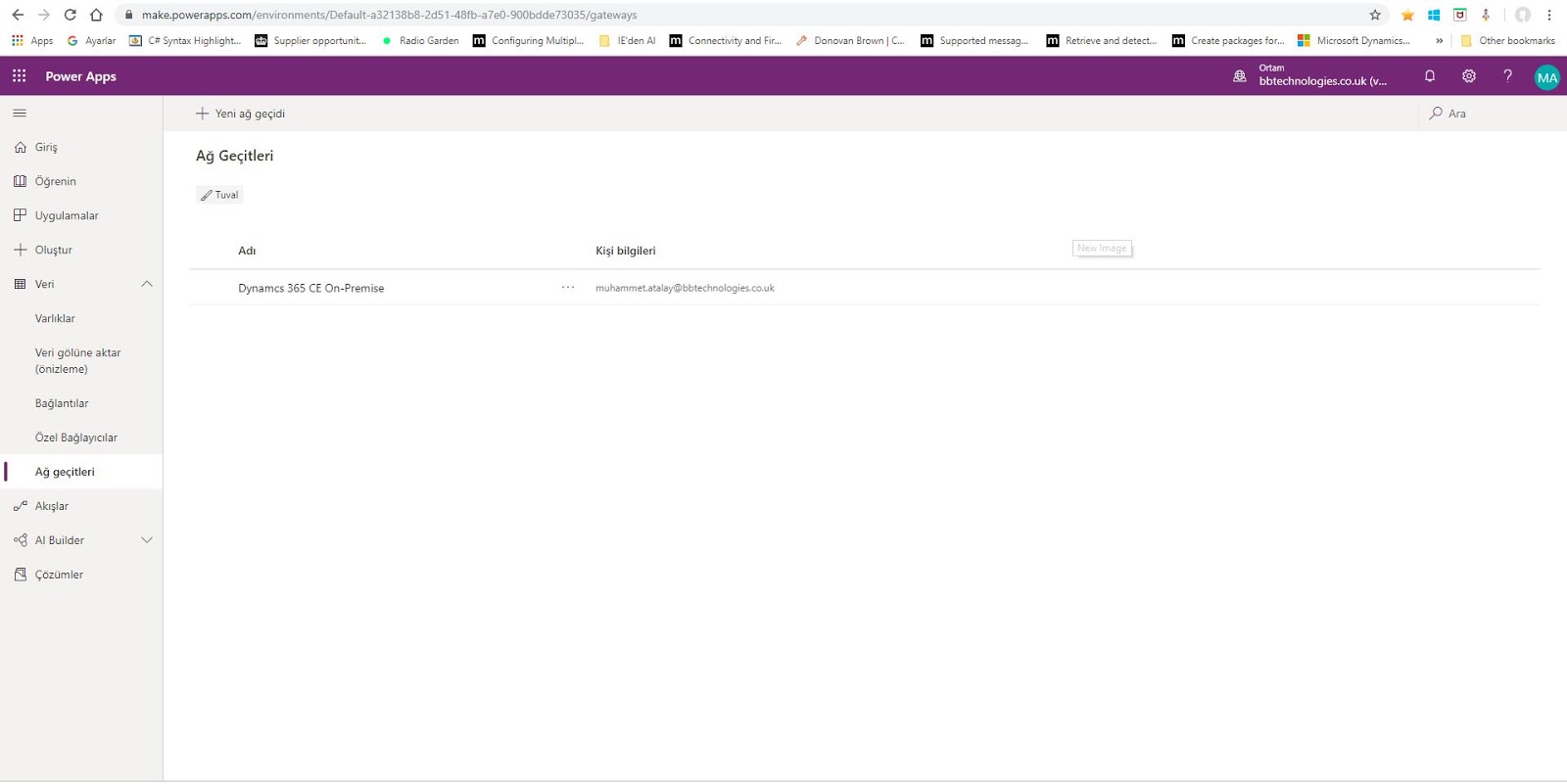

n- connect to https://powerapps.micrososft.com to login with the credential of what you used above.
Screen 19 - Find gateway in the portal

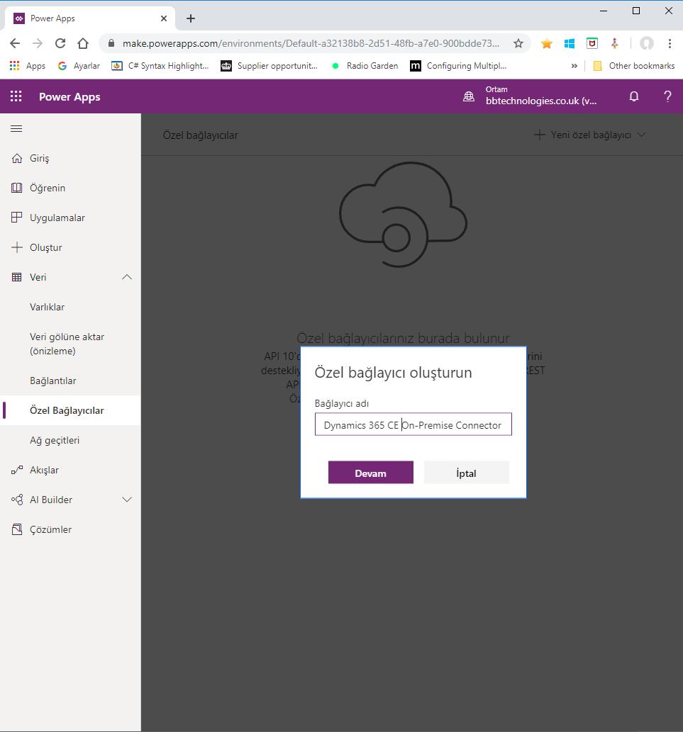

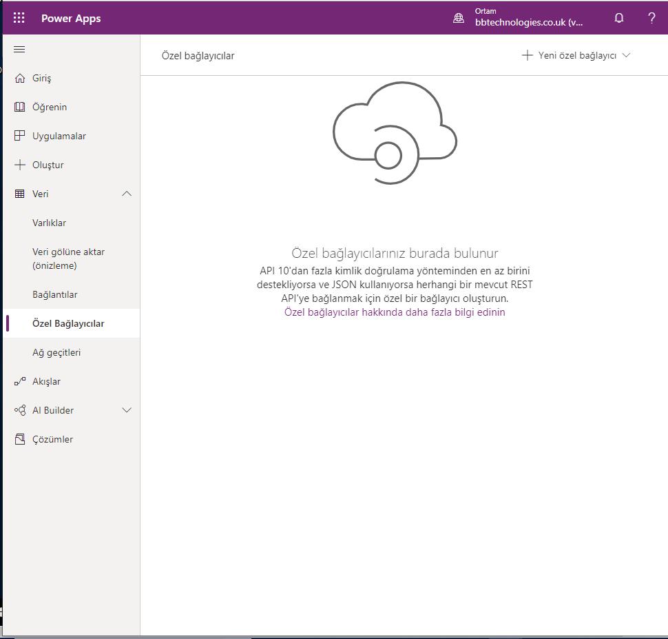

6 - Custom Connector Guide
a - go to powerapps portal then find Custom Connectors from the tree view under Data leaf in the left section.
Screen 20 - Custom Connector
b- Click "New Custom Connector" from + sign right top of the page then choose "Create from Blank"
Screen 21 - Custom Connector Creation

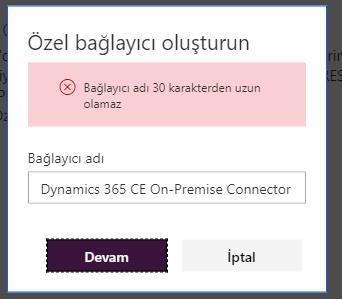

c- give a unique name for the connector
Screen 22 - Type Connector Name
Note : Name must have less than 30 characters
Screen 23 - Maximum length control

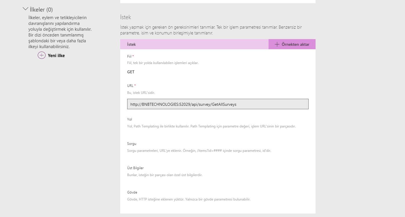

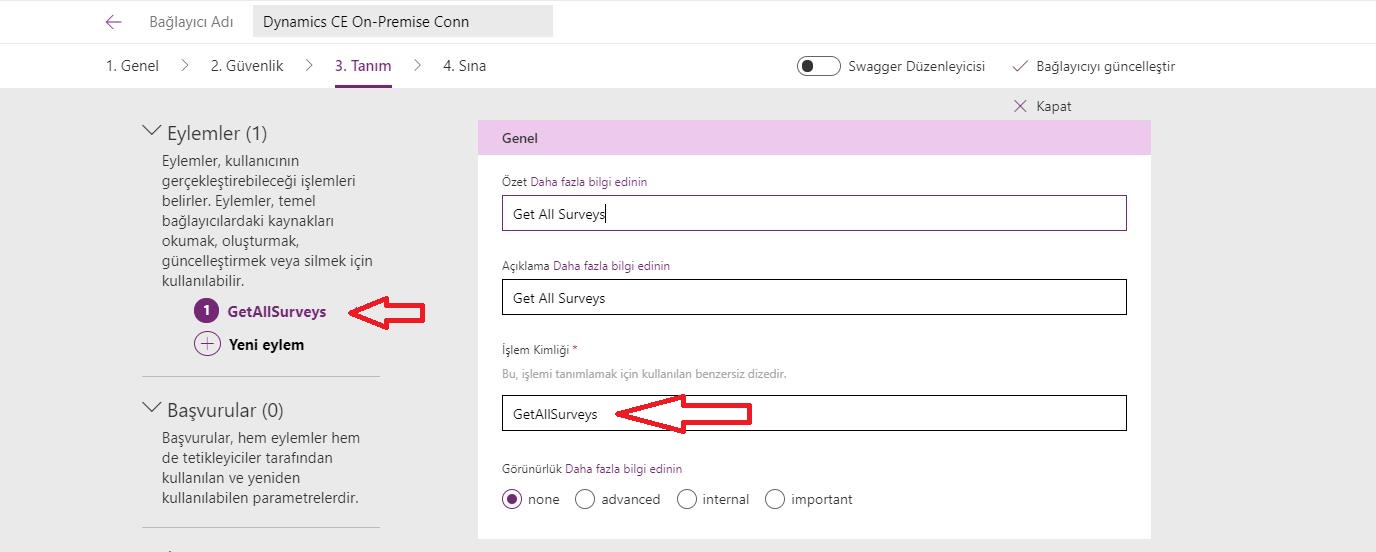

Definition Tab: We need to define the get operation to exists in the WebAPI. If you download solution file from Github page of mine , you will see that There is GetSurvey() method underneath so we can define it as below;
Screen 26 - Get method Definition

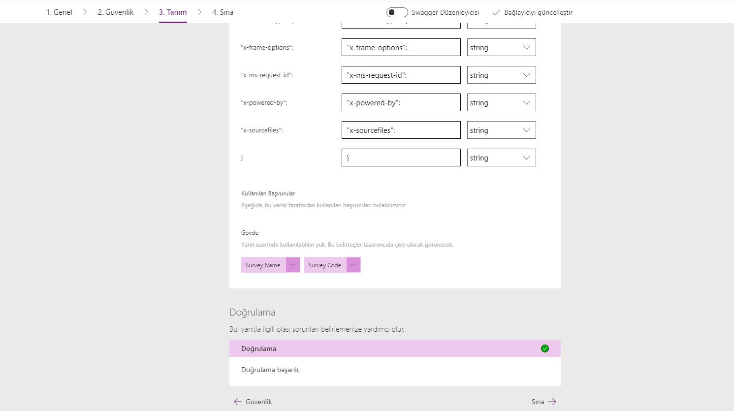

The structure of Request must be defined in the form. Thee is an utility to help us : "Import From Sample", just click + add set Get method with header and JSON body. Swagger will help us to generate all automatically.
Screen 27 - Request Definition

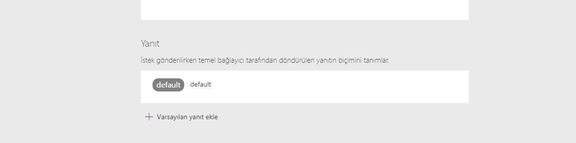

We need to define response of WebApi with columns name.
Screen 28 - Response

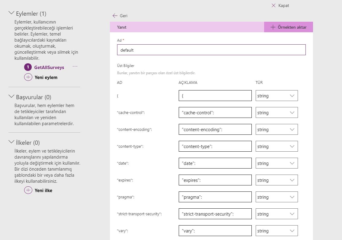

Click "default" to see details if you use Swagger editor to generate all.
Screen 29 - Response Definition 1
Screen 30 - Response Definition 2

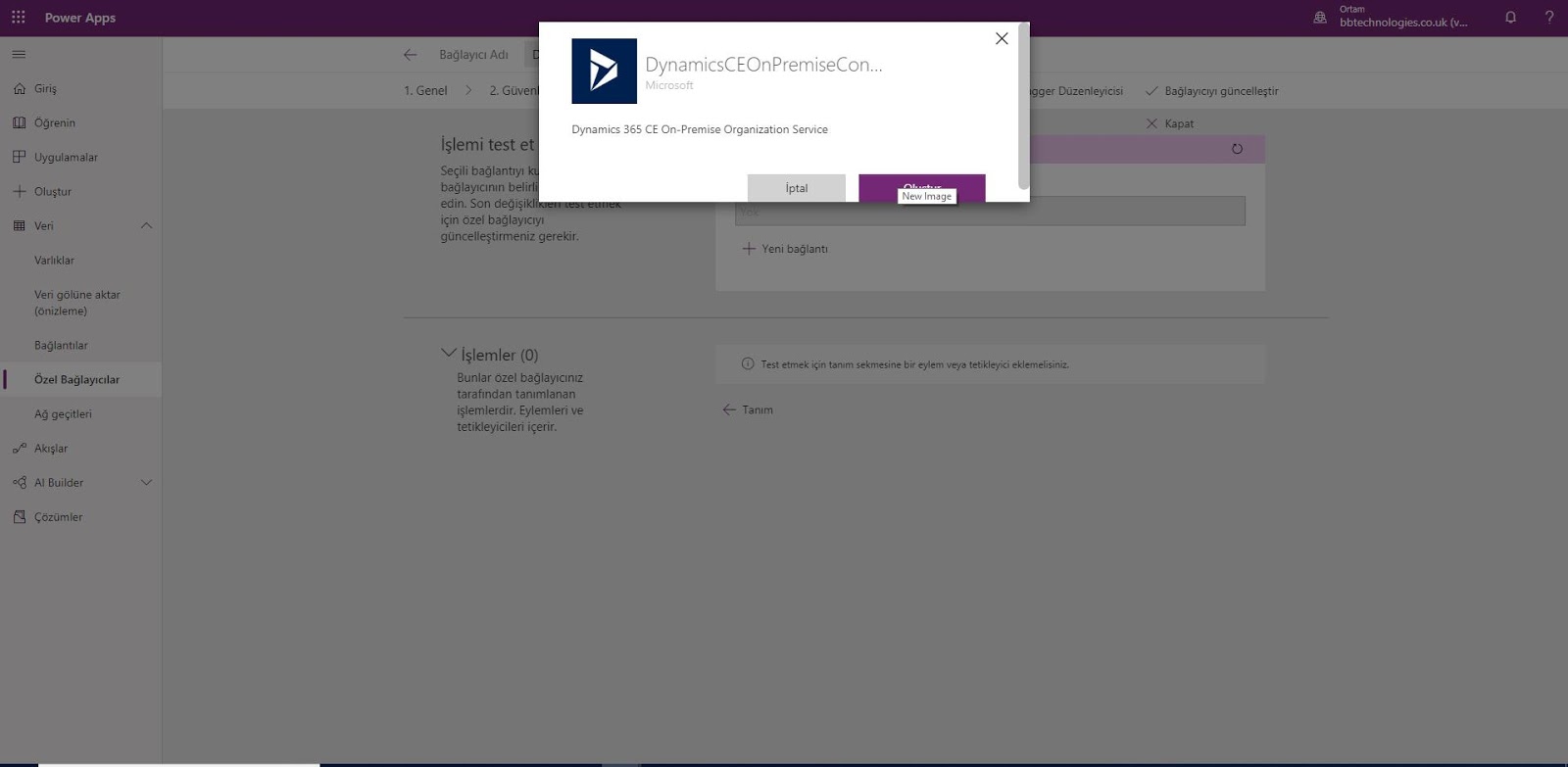

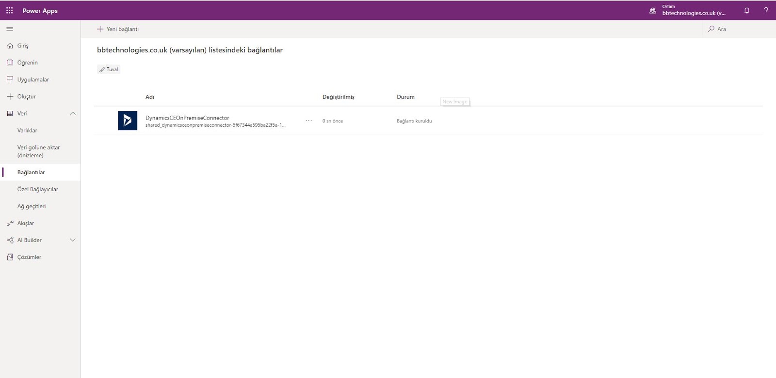

After record creation, We have to already create connection, Power Platform will ask to create connection at the same window. Just type a name for the connection to be used by PowerApps
Screen 32 - Connection Creation
7- Connection: System will create connection in the platform at Custom Connector
Screen 33 - Connection Section

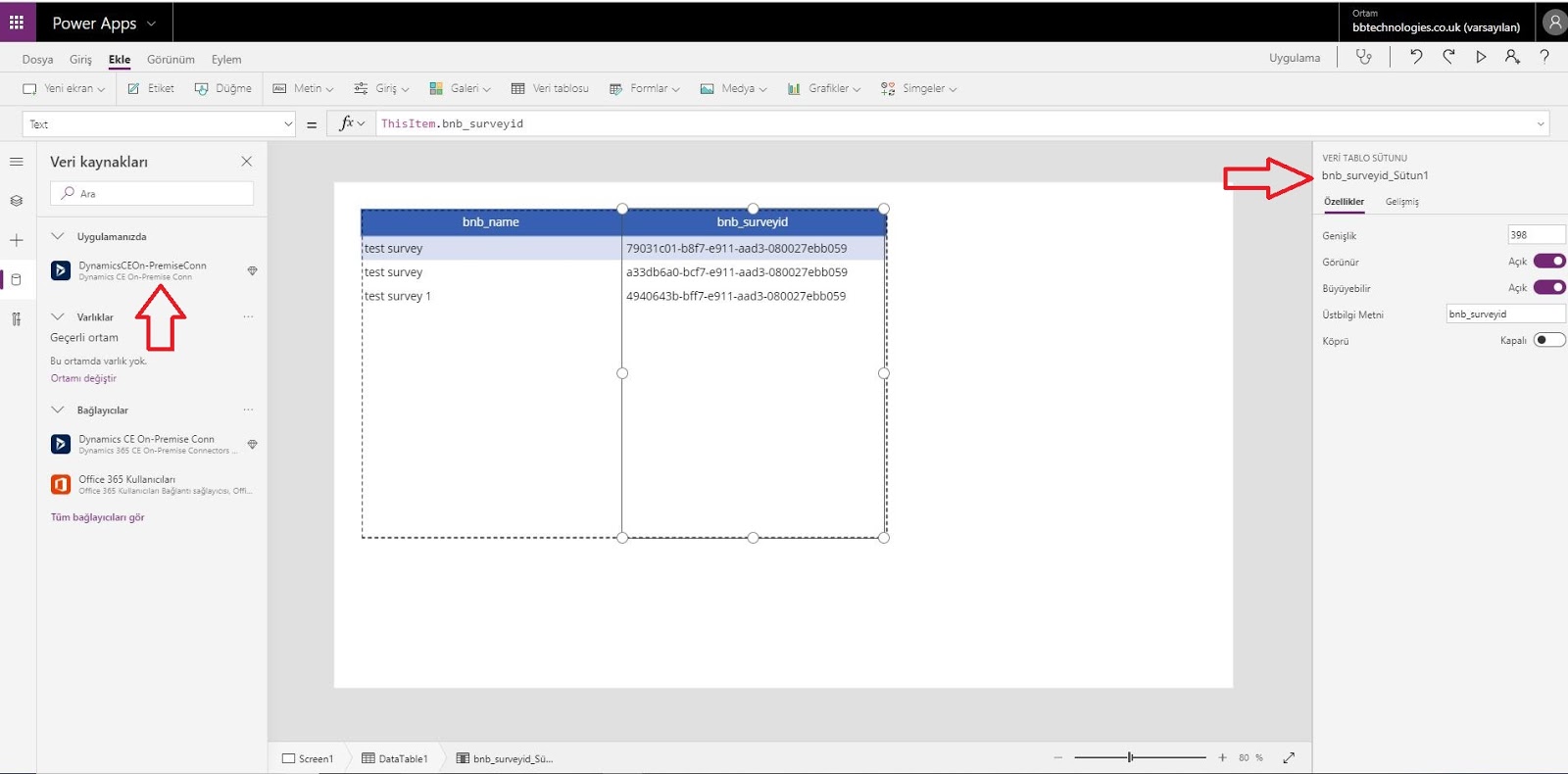

8- Convas PowerApps: Create application on power platform as usual just bind connection as data source . Power Platform UI will list connection to use.
Screen 34 - A sample Canvas Application fetching data from Dynamics 365 CE on-premise
It is very easy :)
