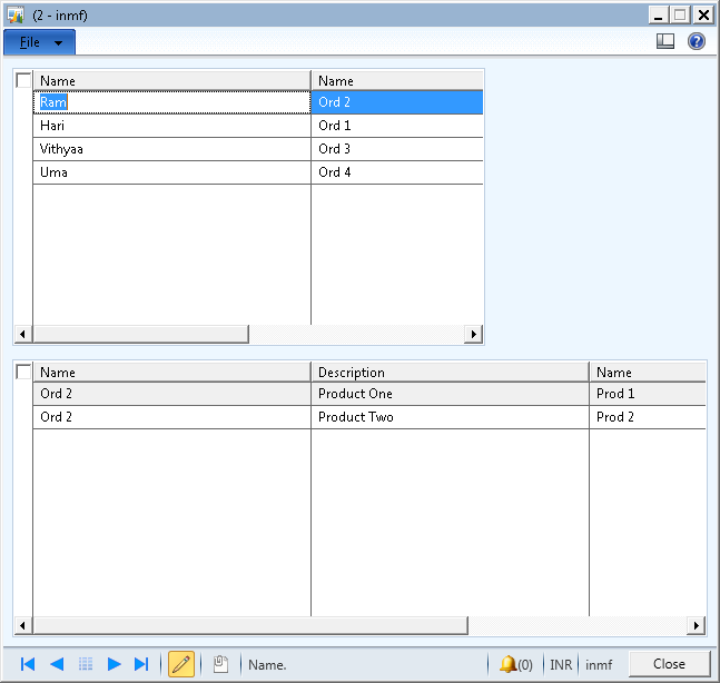

Active
Active link type update the child data sources without any delay when you select the parent table record. When you deal with more records it will be affect application performance.
Delay
Delay form data source link type is also same as active method the different is delay method won't update immediately when you select the parent record. It will update the child data source when you select the parent table, Ax use pause statement before update the child data source. For example, if we are dealing with lot of records so, when the user click or scroll the order, order details will update without any delay if we use active method.
So, We can use delay method because of performance improvement.

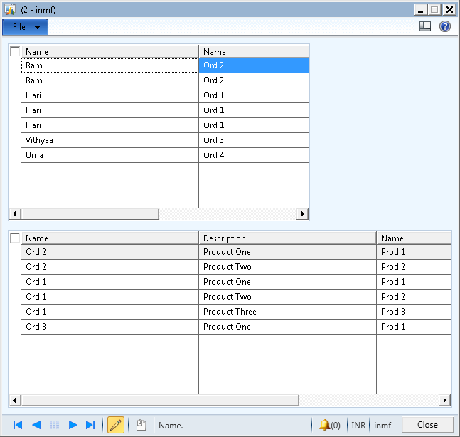

Outer join
Outer join form data source link type will return all parent records and matched child records. It will return all rows in the parent table. Here, Order 4 doesn't has the child records (order details) but it is populating in the order grid. It is the difference between inner join and outer join.
Here, Order 4 is coming even order 4 does not has the order details.

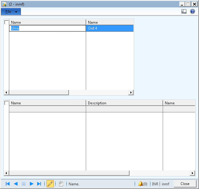

Here, Order 4 is not coming because Order 4 does not has the order details.
Not exist join
Not exist join form data source link type is totally opposite method to exist join. It will return the not matched parent records with child records.
Here, Order 4 is coming because order 4 does not has the order details.
