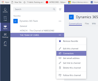

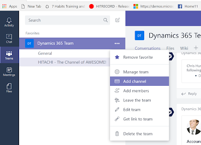

Get a team up and running and create a channel of your preference.

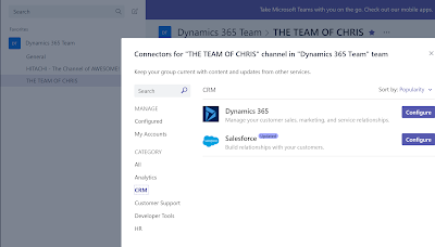

Once you have done that… jump into the menu and hit connectors.
Filter the connectors menu and select Dynamics 365.

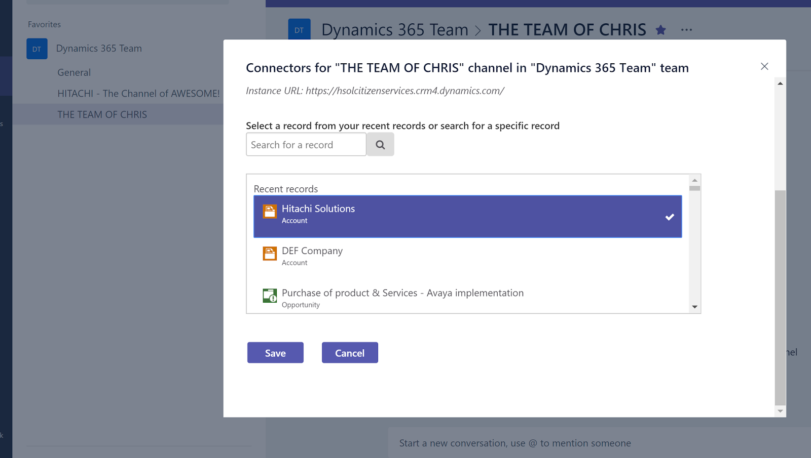

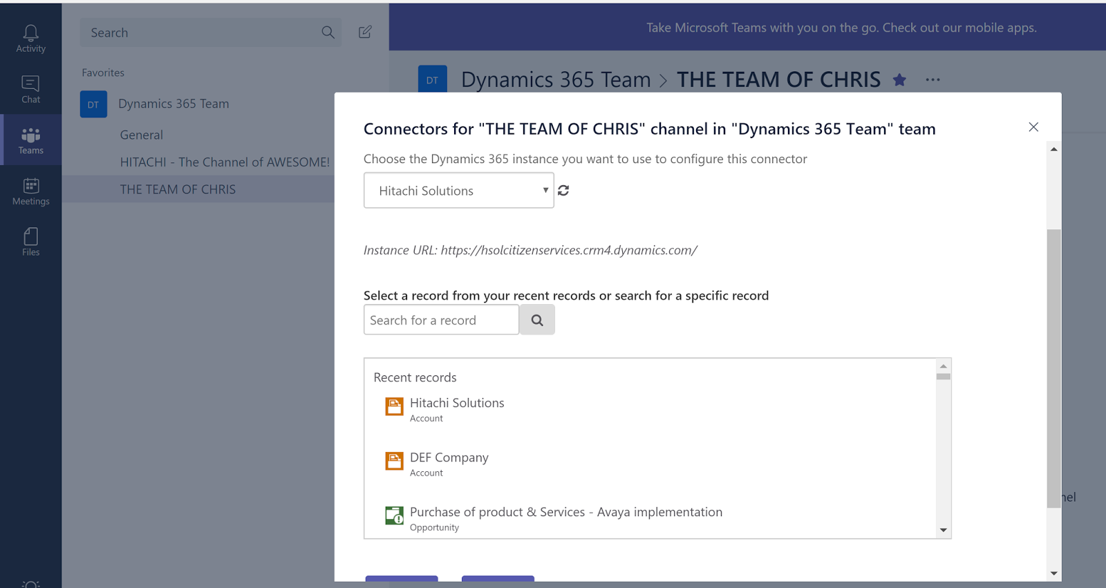

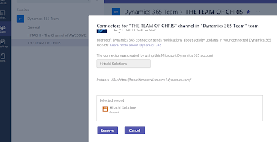

Select the correct instance of Dynamics 365 Customer Engagement. Looks like you need to select an instance within your O365 tenant.
From there select a record you would like to connect with. I only saw the ability to connect with “Accounts”, “Opportunities” and “Leads”. I have a workaround for other records explained at the end of the post for other record (Entity) types.

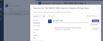

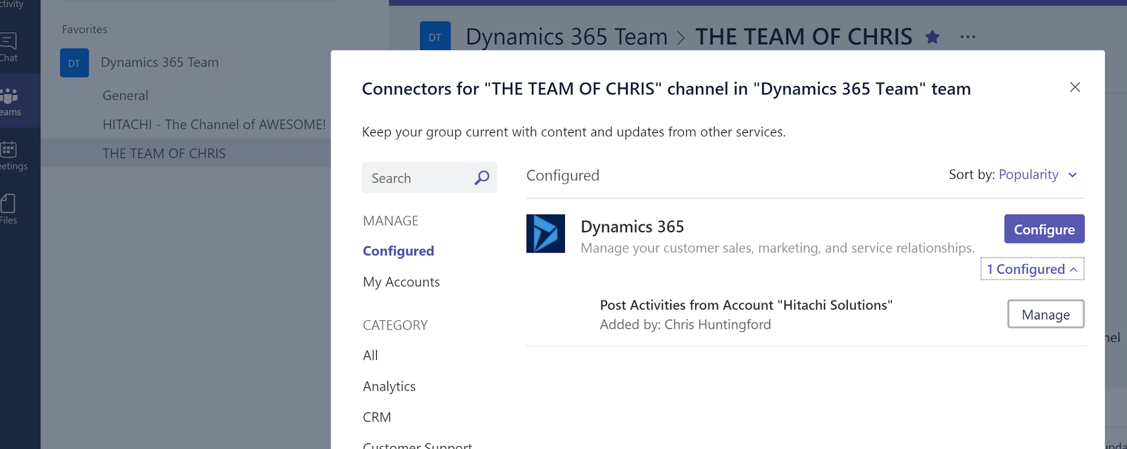

Once you’ve connected to a record (It seems as if you can only select one at a time), you will see the “1 Configured” link under the Configuration button.
If you select the link you only have the option to remove the record. Nothing else. (YET!!!)

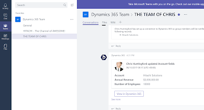

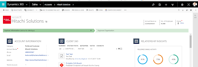

After you have decided not to remove the D365 Customer Engagement records because of its vital importance to your team, you will see an update on your team channel with the records addition details.
I can go into D365 Customer Engagement, search for the record, make my updates and then these will be posted to the Team Channel.
Obvs' you can then click through the Team link through to the Dynamics 365 instance record to review and interact with the record as required.
