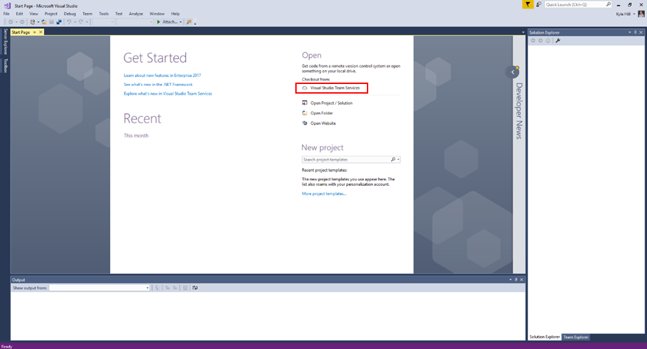

Ok, let's get started. First off, I always like to have my projects under source control. This is fairly easy if you have a Microsoft Live address of sorts. Use this address to log into the Visual Studio online portal and create a new project like so:
1. Login to Visual Studio Team Services here

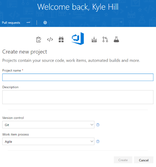

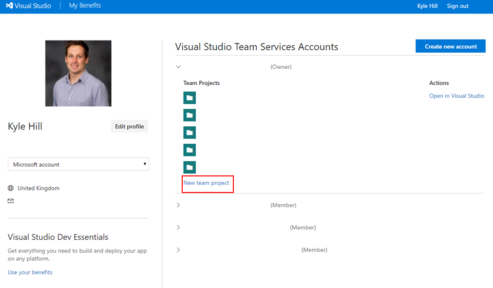

2. Create a new project
3. Enter a project name (Kylie Bot) and description
4. Select a source control type - I prefer TFS so that's what I selected
5. Select a work item process - I chose Agile

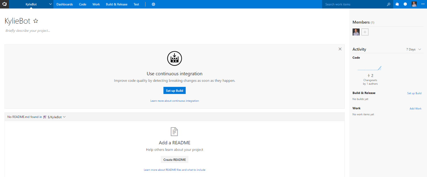

6. Click Create and you should be good to go

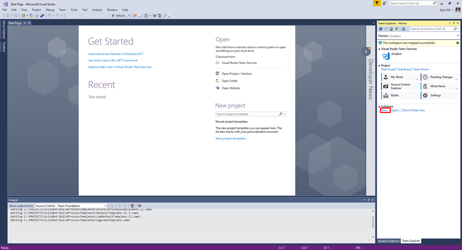

Ok, lots of setup work, lets get started with the actual project. We do this by opening Visual Studio and following this process:

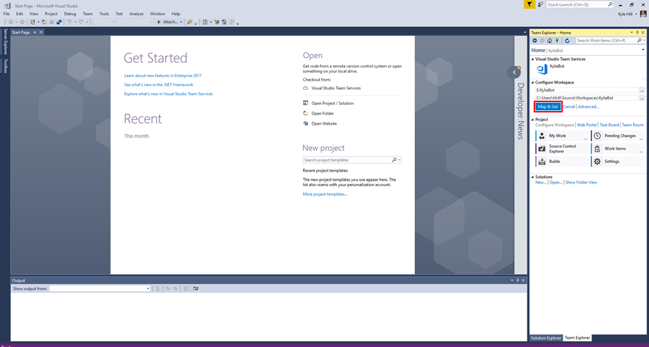

1. Connect to our TFS server from earlier (you may need to log in with the same set of credentials from the earlier steps)
2. Connect to our specific directory and project (Kylie Bot)
3. Map and get the project locally
4. Create the actual solution
5. Select the project template to use

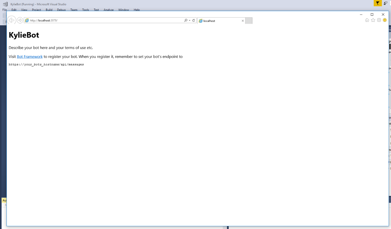

Awesome! Now we should have a fully functional bot. To test this, let's run the project and we should be presented with the following:

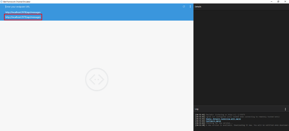

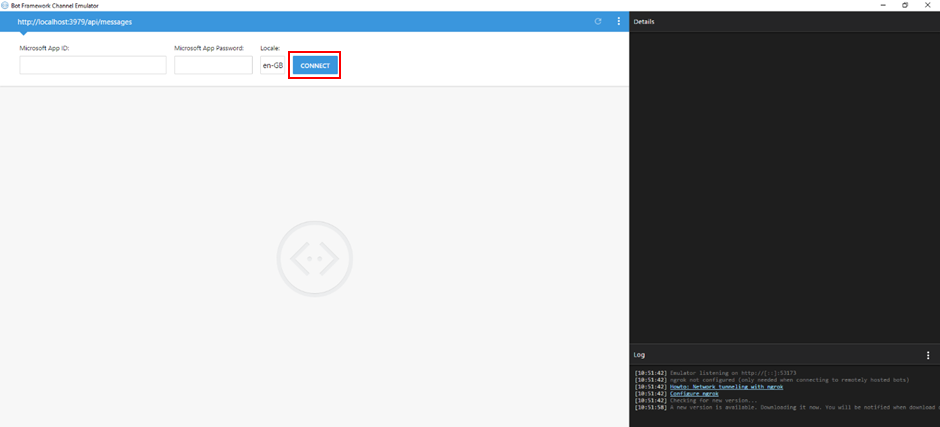

Looks simple but remember that the bot is essentially a web based API that will provide conversations across a number of channels. One of the channels is the emulator that we downloaded earlier. We are now going to connect the bot and emulator. Leave the Visual Studio project running and simultaneously start the emulator which should look like this:
Select one of the options from the drop down in the end points lists (port 3979 is the default so this should work for you too).
Next you will be presented with the option to connect to a specific bot with a App Id and Password. You can leave these blank for now as we will update them in a later post, and click 'Connect'.

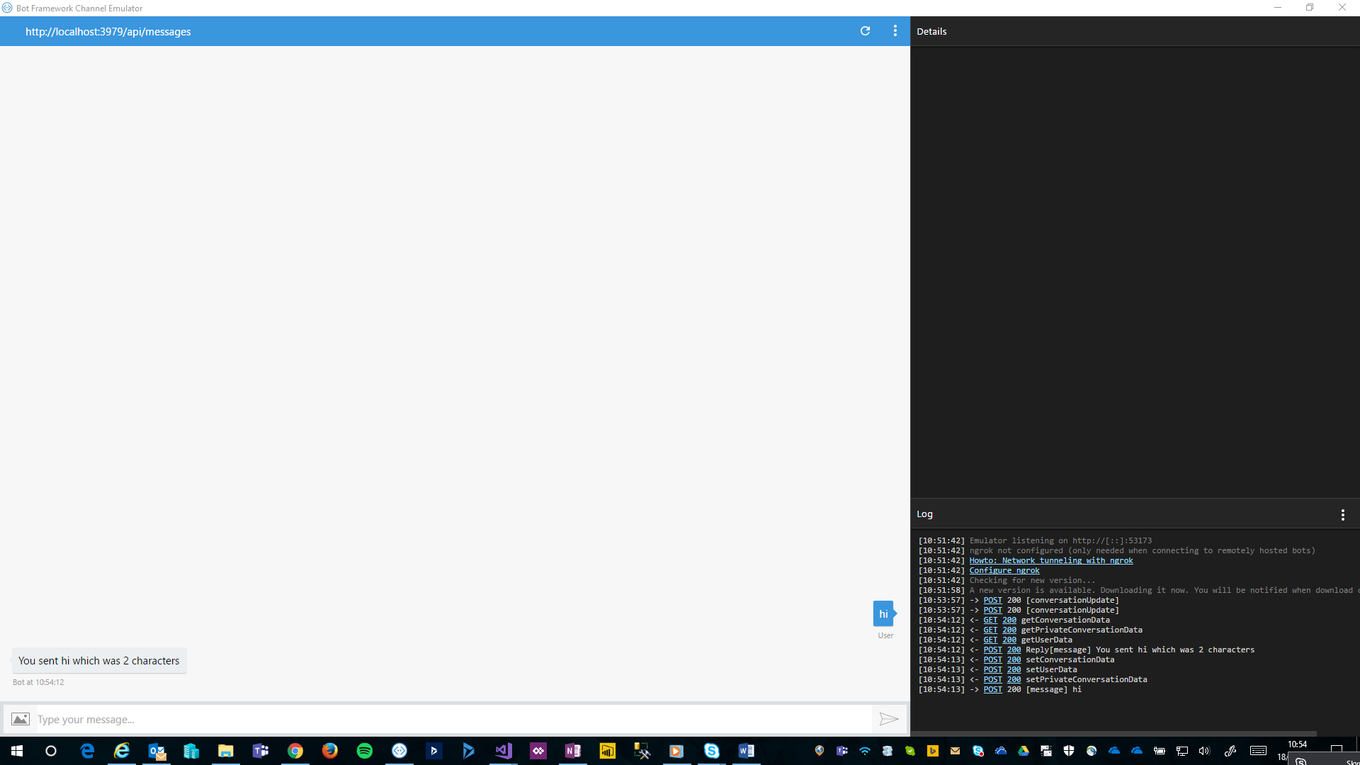

Great, we are now connected. Let's test this by typing 'hi' in the dialog box at the bottom of the emulator and we should be presented with the following:
Fantastic. The bot is working. While it currently doesn't do anything Earth-shattering, we have laid the ground work to be able to extend the Kylie Bot to greater heights.
