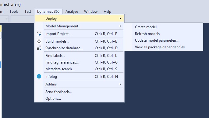

Go to Dynamics 365 or AX7 | Deploy | Create model

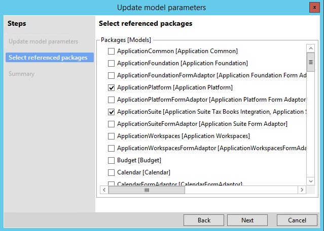

Update model parameters
You may require to update model parameters by adding more reference packages. This can be done as follows;
Select model name to update
Add or remove reference packages
Click Next will take you model summary screen and will update the project in Visual Studio with updated references.
