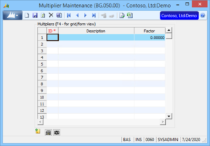

Example 1: Simple one-screen customization within SL
Let’s look at a sample SL screen (a very simple one):
There are very few fields in a single table. This is about as simple a screen as you can have within SL. (A single form view record might be simpler, but that would be a matter of someone else’s opinion.) My BC version of the screen looks like this:
In this case, only a single screen is needed in BC – The table is simple enough that an editable list will handle everything. The screen is recognizable, although there are differences in the details. In most cases, a list and an editable screen will be created for the conversion. The list will handle the functionality of the SL possible value window.

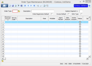

Example 2: SL customization with header and details
Let’s look at a more complex example. This screen contains both a header and a detail section (controlling two tables). The SL screen looks like this:
Because of the added complexity of this screen, it will need to follow more normal “rules” for BC to use a list and entry screen (There are technically three screens for the one – the list, the main screen and the sub-screen for the detail grid). Here’s the list screen:

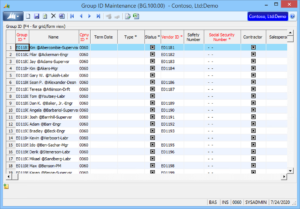

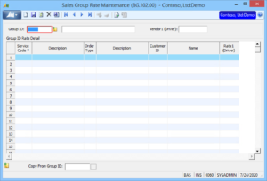

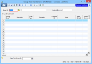

Let’s try one more example. This one makes BC look good – I modified the rules for three SL screens to take advantage of changes that would need to be made for BC anyway. The three SL screens shown below allow for maintenance of a list of employee groups and two different types of rates for those groups.
(One note here is that the values in this screen come from the SL demo database employee table.)
In the two rate screens within Dynamics SL, the header is selected from the list of groups maintained in the first screen. The values from all of the screens are used in the main entry screen for the custom module (which has not been converted at this point because it is much more complex than the ones in our example).

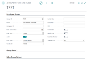

In the BC version of these screens, I have combined them together. Technically, this is still four screens (a list, main screen and two sub-screens), but it appears to be a tighter arrangement:
Again, the list shows just the most significant fields in the header record (the employee group). This opens to the main entry screen shown below:
The two grids for group and sales group rates are in the collapsed sections. They look essentially like the grids on the SL screens, but I can only get everything on screen by collapsing them. As you can see, the work of three screens will now be done on one. Of course, keep in mind that might be a problem when setting up security.
