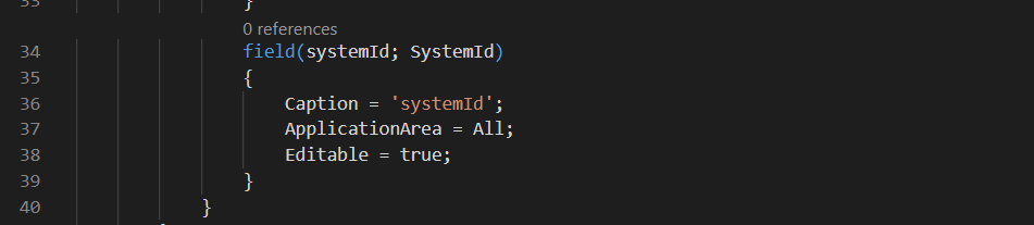

Strangely first error encountered was "systemId is read-only". Looks like platform automatically set the Editable property of the SystemId field to FALSE as a safety precaution.
I set the editable property of the SystemId field to editable in the API page.

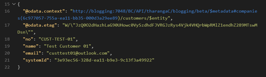

Then I tried the POST API call again and this time D365 Business Central accepted my POST request. However, the SystemId was different from the one that I used in the POST request.
It is due to the platform is overriding the SystemId I pass through the POST request. To handle this new challenge of D365 Business Central generating the SystemID at the insert event, I can handle the insert within the API page by adding below event trigger.
