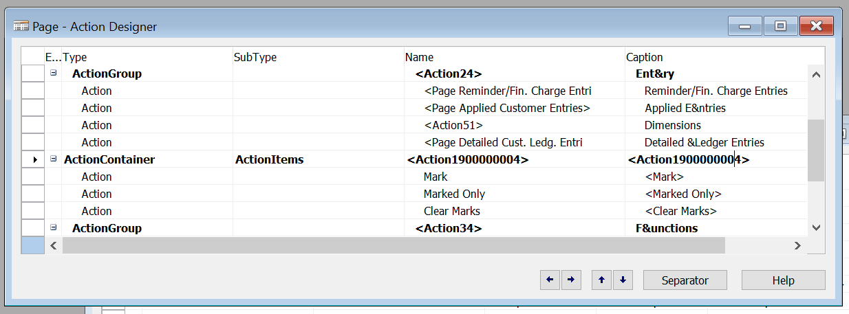

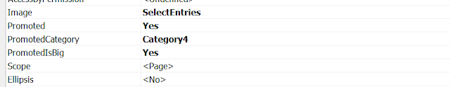

In order to add the buttons, I will open the Customer Ledger Entry page in the development environment and go to Action Designer

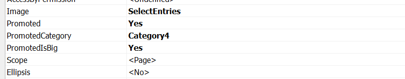

In the action Designer, let's add 3 buttons Mark, Marked Only and Clear Marks. Then I make them promoted and big and also added to Category4.
Then let's write small code to do the work.
Add above code to each OnAction trigger. Once you complete the code it will look like below

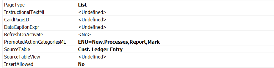

Now we are almost there, just move back to the page designer and open the properties of the page. In the PromotedActionCategoriesML add the Mark at the 4th option (Since we added our new buttons to Category4)

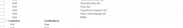

Before we exit from the page we have very small task to do. In order to visualize the Marked records we need to add a new field to the page. Add a new column and set the source field to "MARK".
Once that is been done, compile and save the page.

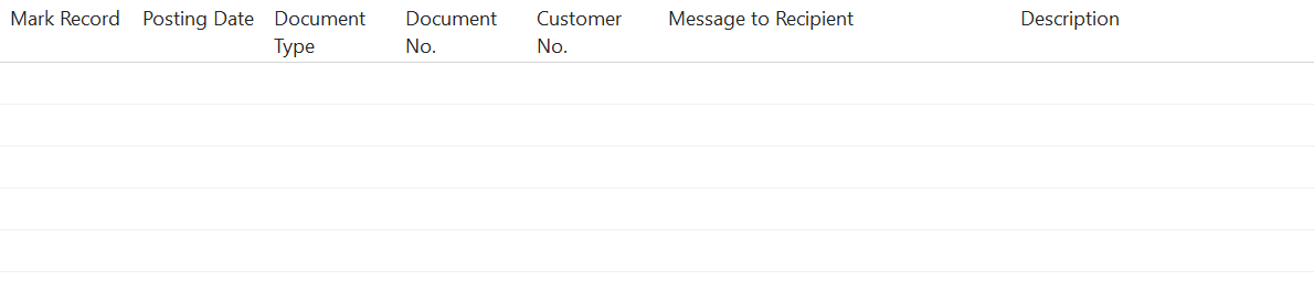

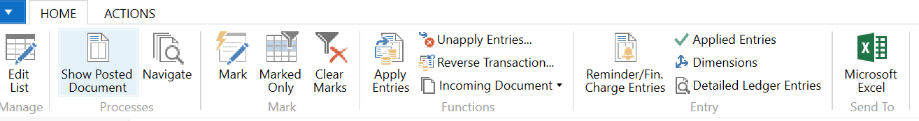

Let's run the page and it will look like below with nice ribbon with the all new custom filter buttons.
Now user can select random records by clicking on the "Mark" button.
When the user click on the Mark button system will select the record and also it will show a tick mark in the page. Once the records are been marked, next step is to filter the marked records to have a one nice view. In order to do that user just have to click on the "Marked Only" button.
See.. System will filter the marked records and create a one simple view. Once the work is been done and user want to un-mark the view, user need to click on the "Clear Marks" button and it will un-mark the records.
But this is a empty record view and what has happen to the rest of the records?? To get all the records just click on the "Marked Only" button again.
User will get the original view with all the entries.

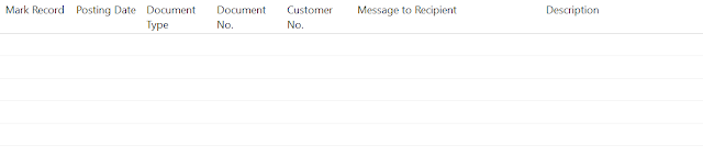

Thank you and Regards,Let's run the page and it will look like below with nice ribbon with the all new custom filter buttons.
