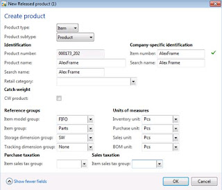

Number of released products will be created in Microsoft Dynamics AX 2012 which will have similar characteristics for the sake of simplicity. All of them will be FIFO controlled, Site and Warehouse will be used as Storage dimensions, default Site and Warehouse settings will be defined for released products and finally cost price will also be defined for all released products (not using BOM calculation for BOMs)
Car frame (AlexFrame) will have the following components: Floor, Roof and 2 Sides
Released product: Car frame (AlexFrame)
Car frame (AlexFrame) released product will be created using decentralized approach
Cost price for Car frame (AlexFrame) is 250$

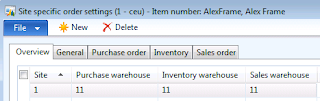

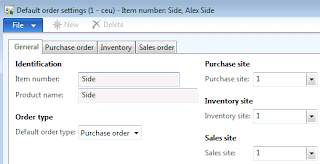

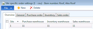

Site "1" will be used as default Site for Purchase, Inventory and Sales
Please also note that Default order type = Production
Within Site "1" Warehouse "11" will be used as default Warehouse for Purchase, Inventory and Sales

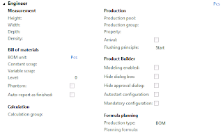

Car frame (AlexFrame) will be manufactured that's why Production type = "BOM"

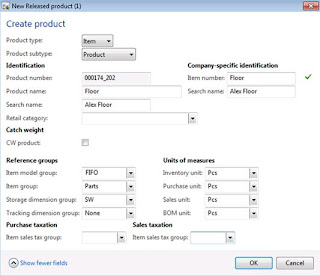

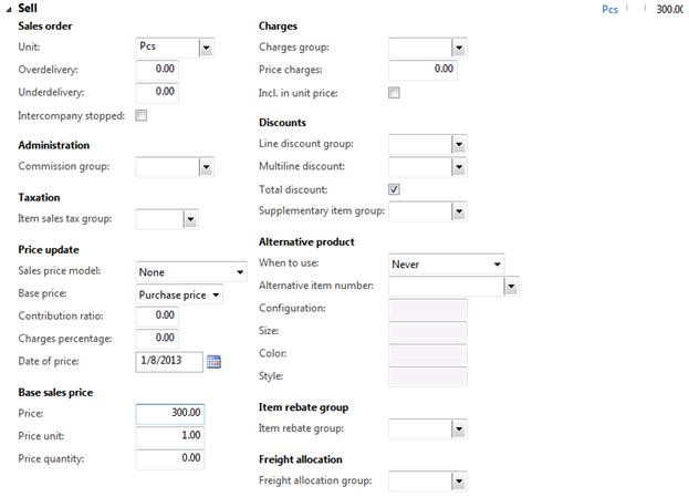

Released product: Floor
Floor released product will be created using decentralized approach
Cost price for Floor is 150$
Sales price for Floor is 300$

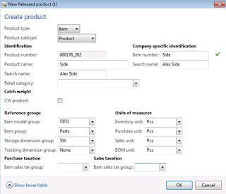

Released product: Side
Side released product will be created using decentralized approach
Cost price for Side is 50$
Sales price for Side is 100$

Please note that Car frame (AlexFrame) have Production type = BOM

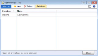

Car frame (AlexFrame) will be manufactured using Welding operation. Before we can define routing we will need to define the operation in the system
Operations

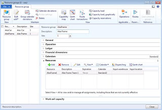

Car frame (AlexFrame) will be manufactured by one team
Resource group: AlexFrame
Car frame (AlexFrame) will be manufactured by Alex Frame Team 1
Resource: AlexFrame1
Alex Frame Team 1 will consists of 1 worker: Ahmed Barnett
Please note that Alex Frame Team 1 will be responsible for Car frame (AlexFrame) manufacturing

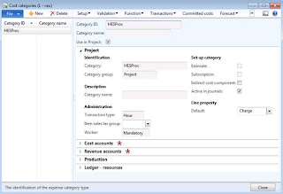

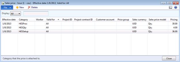

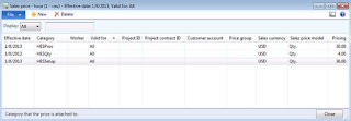

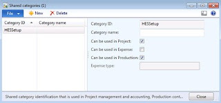

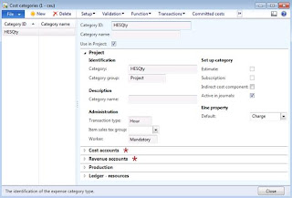

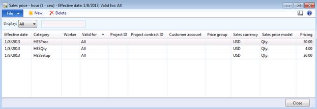

From costing perspective the cost prices for different types of labor will be defined through Cost categories
Cost category: Setup
Cost price for Setup labor will be 18$

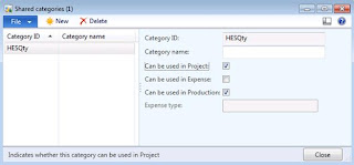

The corresponding Shared category should be enabled for use in Project
Cost category itself will also be enabled for use in Project
Sales price for Setup labor will be 36$
Cost category: Run time
Cost price for Process labor will be 15$
Sales price for Process labor will be 30$

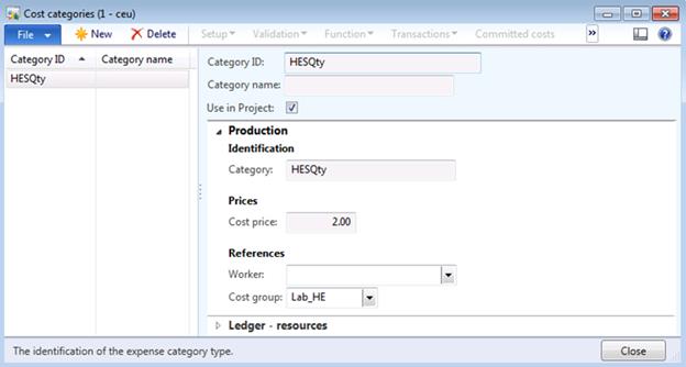

Cost category: Quantity
Cost price per Quantity manufactured will be 2$
Sales price for per Qty labor will be 4$

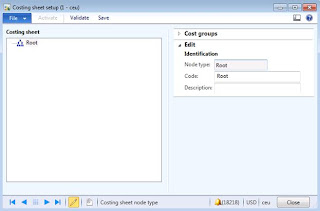

Costing sheet
The structure of manufacturing costs will be defined in Costing sheet
Please note that in the case of project production order Posting method = Consumed the costing sheet should be empty

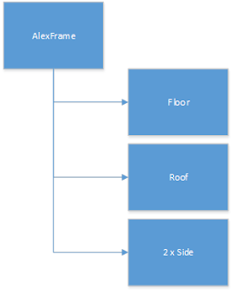

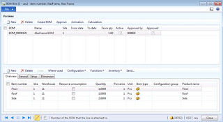

Car frame (AlexFrame) bill of materials will consist of Floor, Roof and 2 Sides
Bill of materials: AlexFrame – Designer view
Designer view provides a visual representation of Car frame (AlexFrame) assembly
Bill of materials: AlexFrame – Lines view
Designer view provides a grid representation of Car frame (AlexFrame) assembly

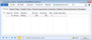

Car frame (AlexFrame) route will consist of Welding operation only
Route: AlexFrame
Please note that different Cost categories are specified for Setup, Run time and Quantity for all route operations
Please note that Resource requirements are specified for all route operations

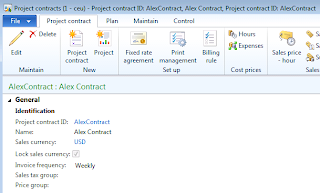

Project contract
Project contract will be defined and linked to project

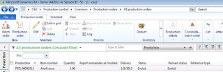

Production orders
When project production order is created you can see it on Production orders list page

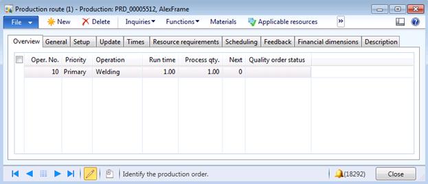

Production order: AlexFrame – Production Route
Production Route is a list of operations to be used for this particular Project production order
Please note that you can change Production Route to meet specific requirements for particular Project production order without affecting product's active Route

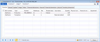

At this moment we will have inventory receipt transaction representing production order receipt for Car frame (AlexFrame) as well as auto loss/profit inventory issue transaction representing consumed to the project Car frame (AlexFrame)
Inventory transactions
Please note that we intend to consume to the project the result of production for Car frame (AlexFrame), that's why the system applies marking for inventory receipt and issue transactions for Car frame (AlexFrame)

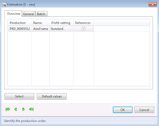

The next step in Car frame (AlexFrame) production order life cycle is to estimate project production order
Production order: AlexFrame – Estimate
It's important to mention that during estimation the system will create inventory issue transactions for BOM components and calculate estimated cost of manufactured product

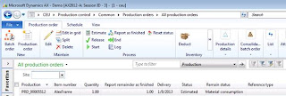

Once estimation is finished you can see project production order on Production orders list page
Production orders

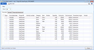

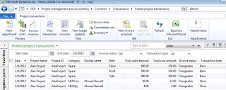

At this point because of project production order Posting method = Consumed you can review Project committed costs related to consumed material and labor

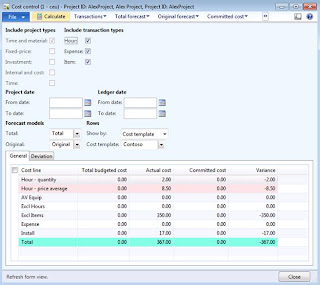

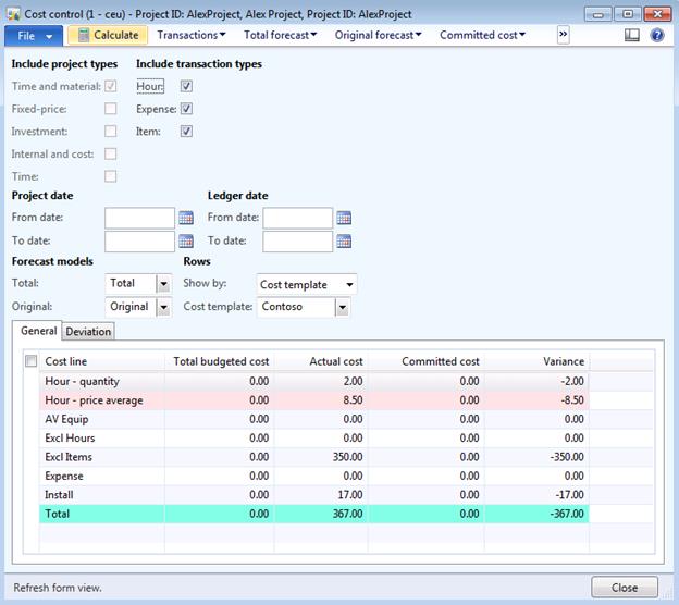

Project – Committed costs

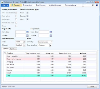

You can do extended project cost control analysis using Cost control screen
Project – Cost control

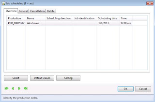

The next step in Car frame (AlexFrame) project production order life cycle is to schedule project production order
In this particular scenario I'll execute Job scheduling which will generate number of jobs and provide exact dates and times for them
Production order: AlexFrame – Job Scheduling

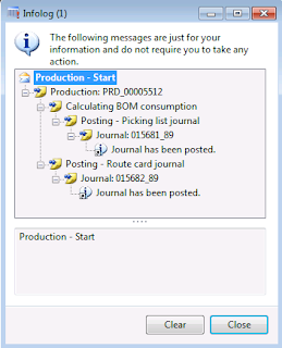

The next step in Car frame (AlexFrame) production order life cycle is to start production order
Production order: AlexFrame – Start
In this case I'll pre-flush materials and labor consumption which means that material and labor consumption will be posted up-front. I'll mark "Post picking list now" and "Post route cad now" checkboxes on General tab. I assume that there's enough on-hand for the components to be consumed in production process.
Please note that you can also back-flush materials and labor consumption which means that material and labor consumption may be posted at the time when you report your project production order as finished

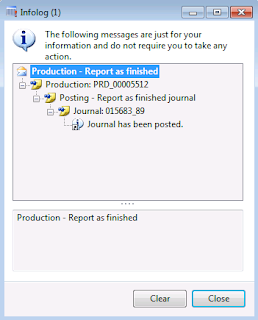

Infolog
As the result the following message will be displayed informing that Picking list journal and Route card journal have been posted for the consumption of material and labor

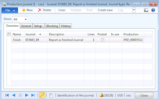

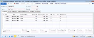

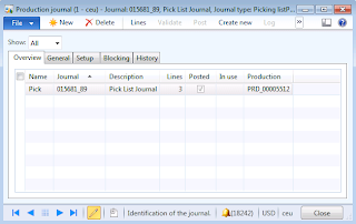

Picking list journal is used to post material consumption
Production order: AlexFrame – Picking list journal
Picking list journal header references Project production order for Car frame (AlexFrame)
Picking list journal lines have details of what components have been picked for Car frame (AlexFrame) production

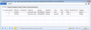

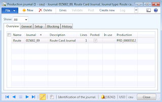

Route card journal is used to post labor consumption
Production order: AlexFrame – Route card journal
Route card journal header references Production order for Car frame (AlexFrame)
Route card journal lines have details of what operations have been performed for Car frame (AlexFrame) production
Production order: AlexFrame – Jobs
Please note that Job status for Welding (Process) job changed to Waiting

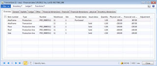

At this moment the system physically updated issue inventory transactions for Car frame (AlexFrame) BOM components. By other words components for Car frame (AlexFrame) have been used in production process
Please note that issue inventory transactions for Car frame (AlexFrame) BOM components changed their statuses to Deducted

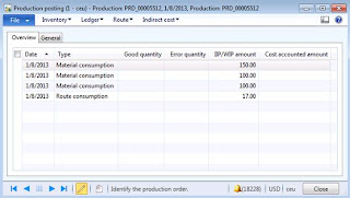

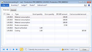

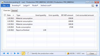

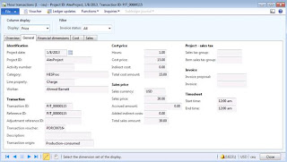

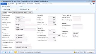

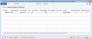

Production order: AlexFrame – Production posting
The result of material and labor consumption for Car frame (AlexFrame) project production order is reflected in Production posting details
Please see details of Production posting for Car frame (AlexFrame) project production order in the table below
Material consumption
Material consumption is 150$ based on cost of Floor BOM component

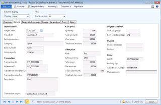

*Inventory transactions

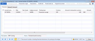

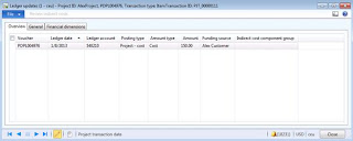

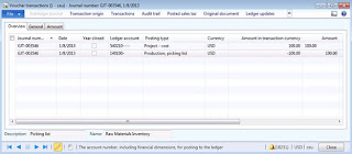

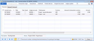

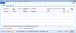

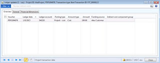

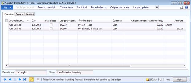

Inventory issue transactions for Floor BOM component will be displayed on Voucher transactions screen for material consumption
*Voucher transactions

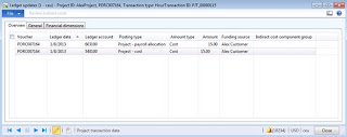

Ledger voucher provides details on which account was credited for "Production, picking list", which account was debited for "Production offset picking list"

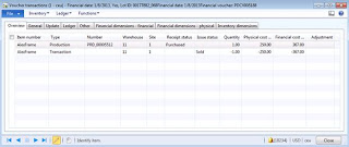

Inventory issue transactions for Roof BOM component will be displayed on Voucher transactions screen for material consumption
Material consumption is 100$ (2x50$) based on cost of Sides BOM components
Inventory issue transactions for Sides BOM components will be displayed on Voucher transactions screen for material consumption
Route consumption
Route consumption is 17$ based on cost of operations for Process and per Quantity for Car frame (AlexFrame)
Inventory receipt transaction for Car frame (AlexFrame) will be displayed on Voucher transactions screen for route consumption
Ledger voucher provides details on which account was credited for "Production WIP issue", which account was debited for "Production - WIP"
*Route transactions
Route transactions show the details of labor consumption postings for Process job (15$) and per Quantity (2$) which rolls up to 17$
At this point you can review Project committed costs related to consumed material and labor
Please note that the system reversed project committed costs for material and labor after material and labor have been actually consumed in production process. The only open committed cost transaction left is for labor Process job because the job itself is not yet Ended

Project transactions
Please see details of project transactions below
Project item transaction – Floor (General)
Project item transaction – Floor (Cost)
Please note that cost price for Floor is 150$ as defined on the product
Project item transaction – Floor (Sales)
Please note that sales price for Floor is 300$ as defined on the product
Project item transaction – Floor (Voucher)
Ledger voucher provides details on which account was credited for "Production, picking list" and which account was debited for "Project – cost"
Project item transaction – Floor (Ledger updates)
Project item transaction – Roof (General)
Project item transaction – Roof (Cost)
Please note that cost price for Roof is 100$ as defined on the product
Project item transaction – Roof (Sales)
Please note that sales price for Roof is 200$ as defined on the product
Project item transaction – Roof (Voucher)
Project item transaction – Roof (Ledger updates)

Project hour transaction – Process (General)
Project hour transaction – Process (Cost)
Please note that cost price for Process labor is 15$ as defined on the cost category
Project hour transaction – Process (Sales)
Please note that sales price for Process labor is 30$ as defined on the cost category
Project hour transaction – Process (Voucher)
Ledger voucher provides details on which account was credited for "Project – payroll allocation" and which account was debited for "Project – cost"
Project hour transaction – Process (Ledger updates)
Project hour transaction – Quantity (General)
Project hour transaction – Quantity (Cost)
Please note that cost price for Per quantity labor is 2$ as defined on the cost category
Project hour transaction – Quantity (Sales)
Please note that sales price for Per quantity labor is 4$ as defined on the cost category
Project hour transaction – Quantity (Voucher)
Project hour transaction – Quantity (Ledger updates)

Production order: AlexFrame – Report as finished
Infolog
As the result the following message will be displayed informing that Report as finished journal has been posted for the receipt of finished goods into inventory

Report as finished journal is used to record finished good receipt into inventory
Production order: AlexFrame – Report as finished journal
Report as finished journal header references project production order for Car frame (AlexFrame)
Report as finished journal lines have details of what finished goods have been received into inventory
Please note that Job status for Welding (Process) job changed to Ended
At this moment the system physically updated receipt inventory transaction for Car frame (AlexFrame). By other words Car frame (AlexFrame) assembly has been produced. Please also note that the system also physically updated auto loss/profit issue inventory transaction for Car frame (AlexFrame) to automatically reduce on-hand because Car frame (AlexFrame) has been consumed to the project
The result of reporting Car frame (AlexFrame) project production order as finished is reflected in Production posting details
Report as finished
Report as finished amount is 250$ based on cost of Car frame (AlexFrame)
<Empty voucher>
At this point you can review Project committed costs related to consumed material and labor. Please note that all committed costs transactions are closed. After reporting project production order as finished and ending Process job the system also reversed and closed committed cost transaction for Process job

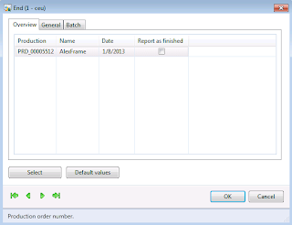

The next step in Car frame (AlexFrame) project production order life cycle is to end project production order
Production order: AlexFrame – End
Once you ended project production orders you can see project production order on Production orders list page
Production orders
At this moment the system financially updated all receipt and issue inventory transactions related to Car frame (AlexFrame) production
Please note that the system recorded financial costs for inventory transactions according to immediate weighted average cost because all products are FIFO controlled
The result of ending Car frame (AlexFrame) project production order is reflected in Production posting details
Please see details of Production posting for Car frame (AlexFrame) project tproduction order in the table below
Costing
Costing amount 367$ reflects the actual cost of project production order which includes material consumption and labor consumption
Inventory transactions related to Car frame (AlexFrame) will be displayed on Voucher transactions screen for costing. This includes original receipt inventory transaction and auto loss/profit issue inventory transaction
Please note that the system recorded 0 (Zero) voucher transaction in order to account for product receipt after the product was consumed to the project and subsequent financial activity will happen in project accounting module

You can still do extended project cost control analysis using Cost control screen

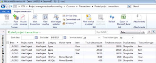

Since the time when project item and hour transactions have been posted against the project, they are ready to be included into Project invoice proposal in order to invoice the customer
