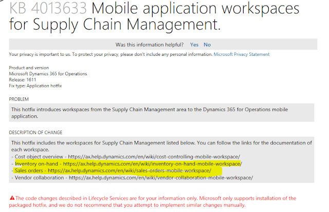

Step 1:
Go to LCS > Project > Issue Search and search for the below KB or just click on this link
KB 4013633
Step 2
Download KB 4013633 (an X++ update or metadata hotfix). This contains four mobile workspaces for supply chain management.

Step 1:
KB 4013633
Step 2

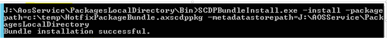

Step 4
Log in to your VM and then use the SCDPBundleInstall command
SCDPBundleInstall.exe -install -packagepath=c:\temp\HotfixPackageBundle.axscdppkg -metadatastorepath= J:\AOSService\PackagesLocalDirectory
Tip - Note in some of the later VM's you will find the SCDPBundleInstall in the Bin directory inside PackagesLocalDirectory i.e. J:\AOSService\PackagesLocalDirectory\Bin

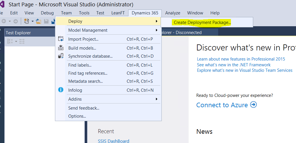

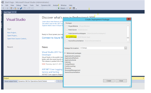

Step 5
Once the bundle installation is successful, next step is to go to Visual Studio and create a deployable package as shown below:

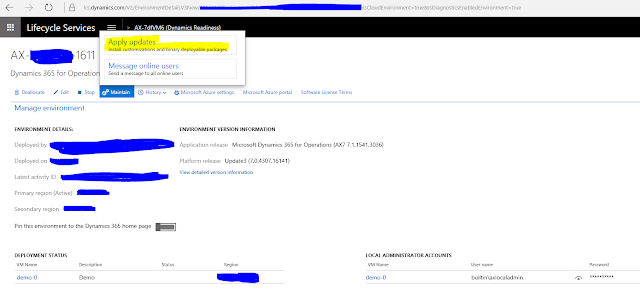

Step 8
Now, you should be able to go to your environment where you want to apply the deployable package and then click on Apply Updates from maintain environment and select the deployable package and start deploying.
The environment will go into Servicing state and no one will be able to use the environment at this point. This may take 1 to 2 hours to get deployed.
